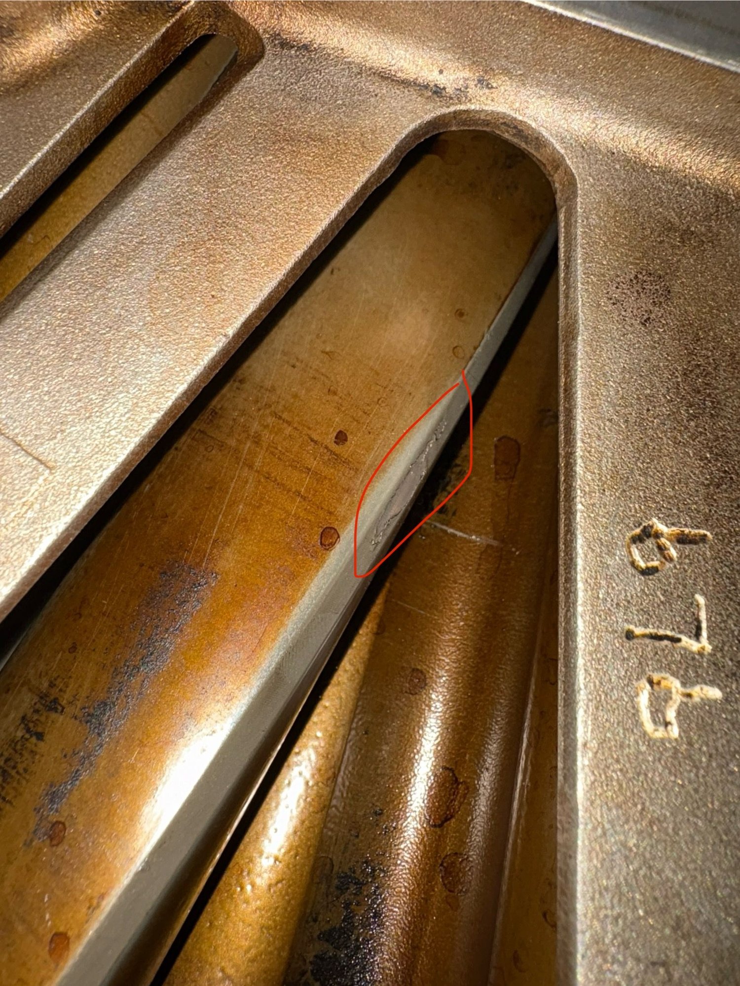

while I was cleaning the rotors of the supercharger I noticed some sort of coating coming off the rotor.
Can see it a lot better in
Should I be concerned?
Im sending the supercharger to powerhouse in a month or 2 would they be able to fix this?

Have the supercharger rotors recoated and change the oil.
Would I still be able to drive the car with the supercharger for the time being?
Can see it a lot better in THIS VIDEO
Talk to Magnumpowers, they can re coat for you.
