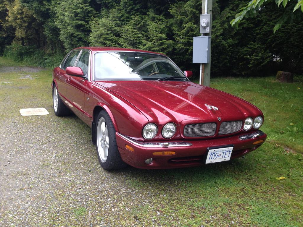

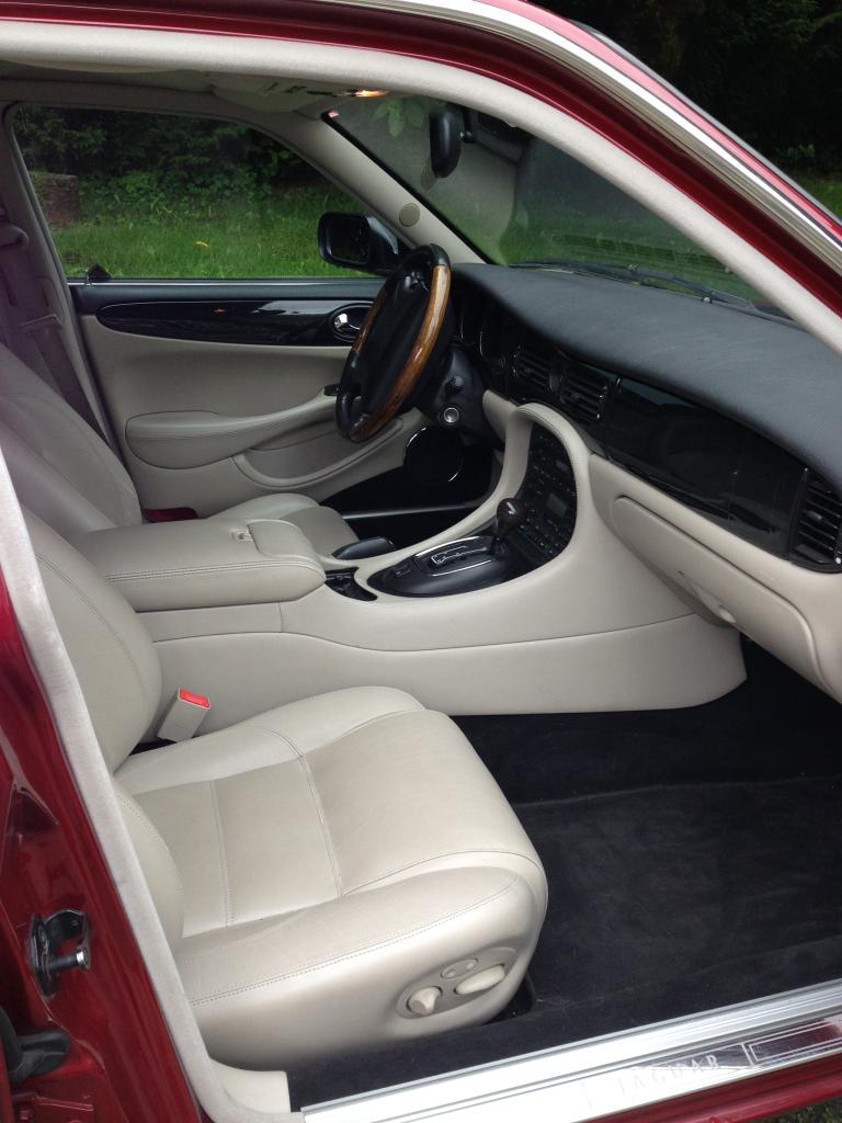

Well, I went to see it and it's very pretty. Red/burgundy/maroon in colour. Black and white interior (without woodgrain, is this normal for an XJR?), generally very clean inside and out.

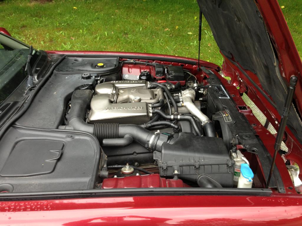

No oil in the water, no water in the coolant tank. Apparently is being dumped overboard through the expansion tank. On startup there i a loud rattle from the front. It stopped within a second or so. It is running rough, with more white smoke from the left bank than the right. Steam and a smell come from the coolant tank after it runs for a minute.
It still sounds like a head gasket to me. I could not find the engine number, so I am assuming it's original. The car is Canadain, and I am told from BC where I live. This is important due to road salt concerns.
There was a check engine message but I didn't have my OBDII reader. As mentioned before, 89,000 miles. Super clean interior, very nice paint decent factory rims, tires ok but getting low on tread. Brake discs look ok but some wear. Exhaust is solid, dunno what else to say. I have video and pics, not sure how they turned out.

The dark stain wood is standard on the R of that year.
