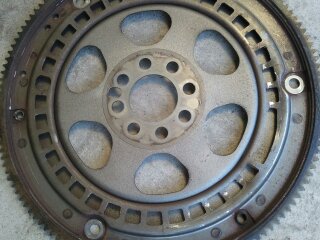

Hi Everyone!!
Feeling so good today. I finished the job yesterday when the engine started, first touch of the key at 15.17hrs!
It feels like I haven't slept for two weeks... all down to this mistake... please see photo attached.
The problem for me has been that only an experienced repairer with knowledge of the risk of jamming the flywheel in the wrong place to remove the the harmonic balancer, would check it. Preston Jags say they have come across this fault more than once.
They also told me that they have only ever replaced head gaskets on supercharged Jag engines ... interesting!
The job of replacing the flywheel/drive plate, took me approx. 10 hours. I worked on my own and maybe two people would have reduced this time somewhat. I had the use of my friends vehicle lift and a transmission jack.
I would say the most frustrating and difficult part was wrestling with a corroded and heavy exhaust system. The front section was corroded to the intermediate section and the cats were seized to the down pipes, so I had to disconnect from the manifolds and work around a half floating set of pipes... reconnecting to the manifolds after disturbing the system wasn't easy!
The gearbox was therefore tethered to and suspended on the jack and removed into the transmission tunnel about a foot to the rear... just enough to manoeuvre the replacing of the drive plate.
When disconnecting the gearbox fluid cooler pipes, I was expecting a potential flood, however there was only a very small, negligible trickle.
I was advised by Preston Jags to beware that if I should remove the positioning dowel in the crankshaft boss, for the drive plate, that there is a possibility of two positioning holes spaced at 180 degrees within the crankshaft boss ... so 'unless I wanted to repeat the ceremony thus far', I should mark the old drive plate and ensure the replacement was in the same position when re fixing so as not to have the timing 180 degrees out.
I unfortunately bent the gear selector lever when disconnecting the selector cable from the side of the gearbox, it's only a very light metal bracket and easily bendable, the result was that when I did start the engine, in the 'Park' position ... the gearbox was in fact in 'Reverse' and nearly ran myself over (a fitting end to a short but illustrious career?)... By 'unbending' the bracket until the gear selector slotted correctly into the indents, all was well.
