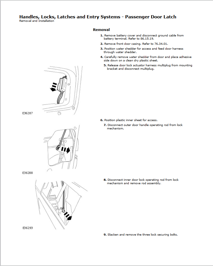

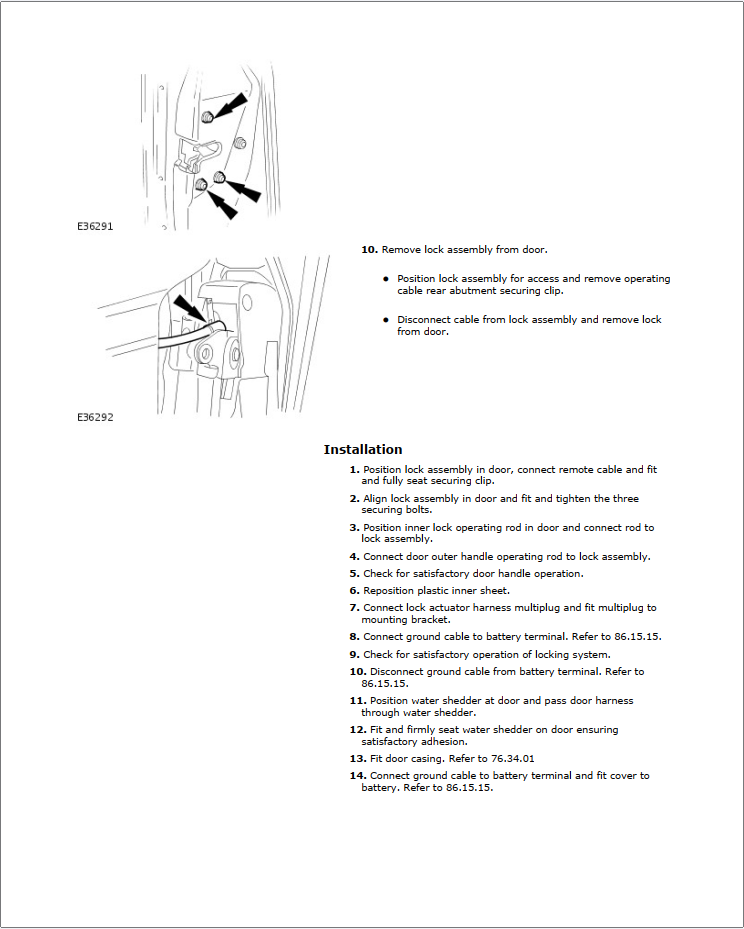

This is my drivers door when I did my handle seals to give you a live idea of what you'll be looking at, but the assembly is the same.
The drawn instruction detail is from the X308 Workshop Manual so you have the breakdown procedure.
