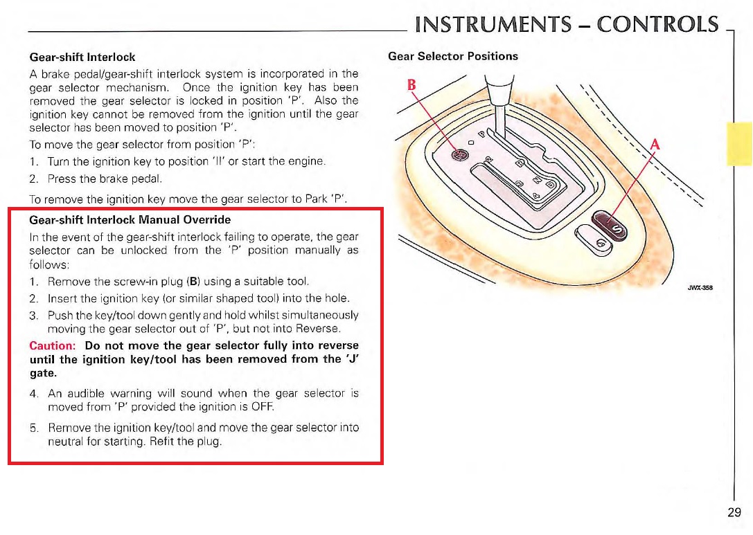

To get over the immediate issue of not being able to shift out of Park, use the Manual Override procedure (see section boxed in red):
Although it could be a failed Interlock Solenoid causing this specific issue, the fault list suggests there's more to it.
