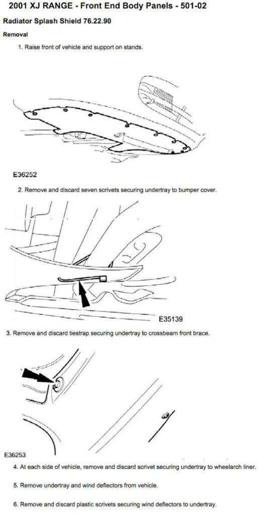

ok I have a 1998 Jaguar xj8 and I need to remove the AC Compressor to install the new one I have disconnected the old compressor now I cant get it out the car. I was told to remove the undertray/fan cowl what is that do you have a picture of that

Hi Marcus

I extracted the instructions and illustrations from the JTIS21 Jaguar Shop Manual.

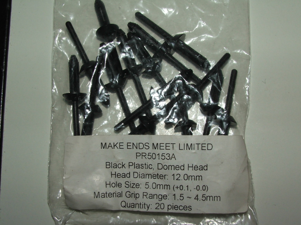

You have to use an 1/8th drill to drill them out.
The screw rivet is a standard motor part, you can buy a bag of 10 for $2, they fit in a standard rivet gun to fit use the largest hole fitting.

The other way of doing it is to replace the scrivet with a push in type fastener, like the inner wing fasteners.
