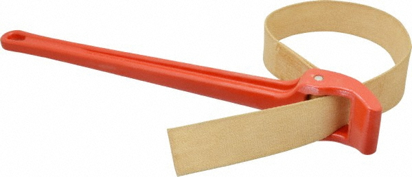

ARGghh.... Front crank seal leaking, would this strap wrench help with pulley?

Have a look at this 2 Piece Rubber Strap Wrench Set strap wrench from Harbor Freight.
My 4 lb pulley came off pretty easy, and I had replaced it with the stock pulley.
Now I am trying to remove the stock pulley and it is "resisting" being removed.
I've tried my entire "French" vocabulary, but surprisingly, that has not helped.
The problem is the familiar one of the crank pulley turning.
Has anyone tried using a strap wrench to hold the crank pulley still?
I really don't want to pull the radiators to allow me to use an impact so I'm focusing on trying to immobilize the crank pulley somehow.

I doubt it. I used a much bigger, tougher Ridgid pipe tool strap wrench with a pipe over the handle and it sure did not seem to "have any extra"!
Attached Thumbnails ARGghh.... Front crank seal leaking, would this strap wrench help with pulley?-7478019-23.jpg

Rope in the compression stroke trick. 100% resistance.

Originally Posted by XKRacer
I thought you bought the correct tool??
You would of done it in no time at all instead of all these cowboy methods
I did buy the correct tool to allow me to tighten the bolt. This tool is the big long bar that attaches to the pulley, but you cannot use that tool AND a pulley puller at the same time.
But the pic you showed which was the same as I showed included the puller? Once you got the bolt out you remove the handle and then fit the puller and take it off !!!!
Theoretically you should also use the flexi plate lining up tool but this is not necessary, I never do when I am just doing a pulley upgrade...

The bolt came off easily, it is the pulley itself that refuses to be moved.

That's easy then..... I have had stubborn pulleys before, I must admit not so close after being fitted, what I do is fit the puller and tighten it up to the point you are turning the engine over and then smack it with a hide hammer, only had one who was a bit more reluctant and took a lump hammer under the same procedure, always came off...... Give it a go unless you don't mind paying the money......

try putting a lump of softwood on the belt surface of the pulley and tapping it with a hammer while still under tension of removal tool. it do not look like it has done anything, but the tool can be tightened some more. my pulley fought all the way to the end of the crank.
