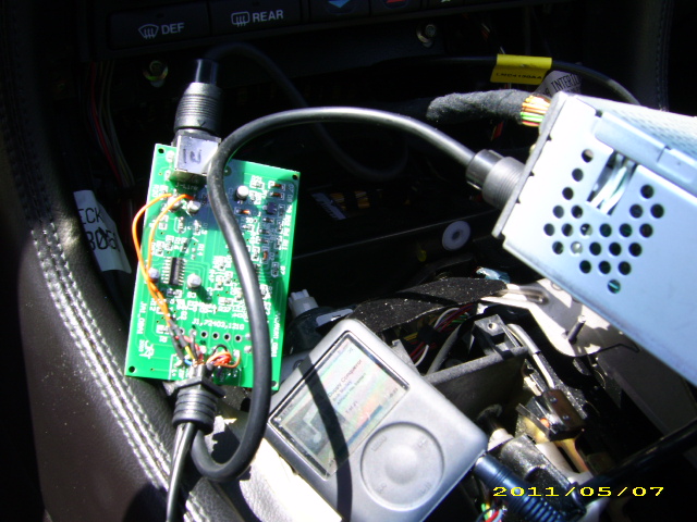

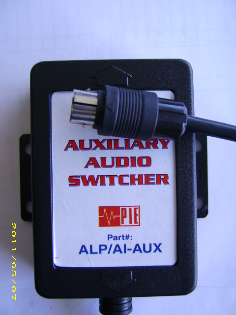

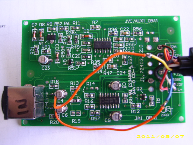

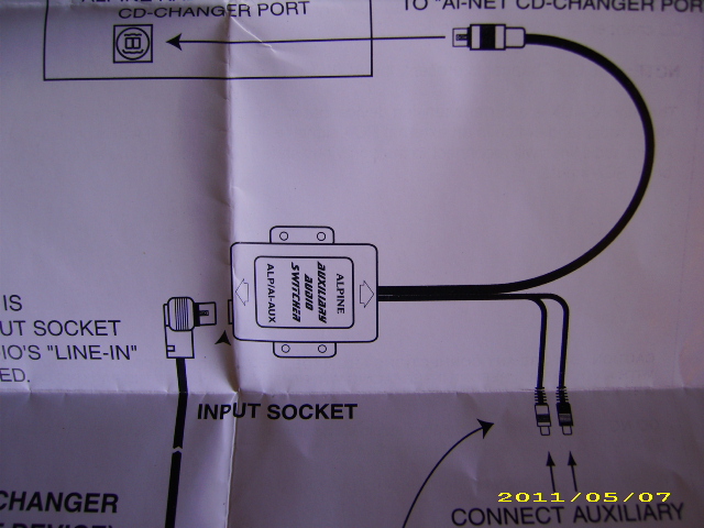

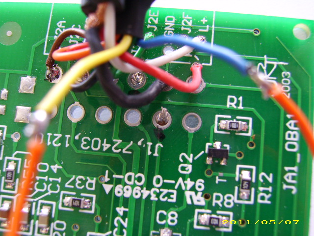

I have installed the PIE unit up at the head unit of my XJR with Nav and Alpine premium and as shipped, the PIE unit is not wired for direct plug and play. The cable is audio out and need to be In so I had to modify the PIE AI/AUX unit as detailed here.
https://www.jaguarforums.com/forum/x...e2/#post347463
Now CD works on CD, and AUX works on Radio or Tape, so if I have a dummy tape in, then any audio silent passages stay silent.
Streaming audio works through the T605 bluetooth install.
Nearly modern.
I should have installed a 12V outlet in the Center console for charging, maybe next weekend.
Aux In Through CD Changer Cable-dsci0075.jpg Aux In Through CD Changer Cable-dsci0063.jpg
Original unit that we need to modify

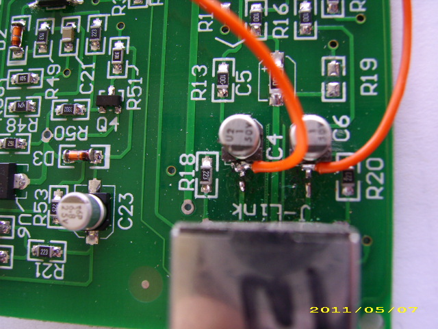

Extending Audio cable leads
Cut track and add extensions from the capacitors.
Aux In Through CD Changer Cable-dsci0059.jpg Aux In Through CD Changer Cable-dsci0060.jpg
Top and bottom views. Not pretty, but it works.

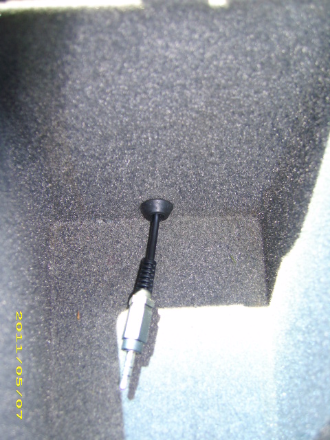

3.5mm inlet in console.

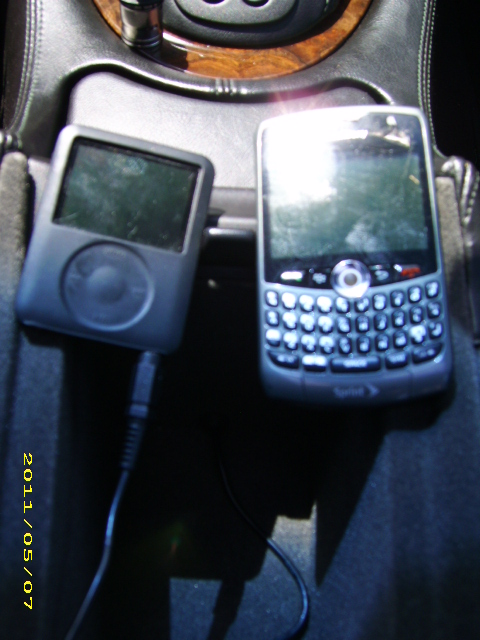

iPod and bluetooth phone streaming all working on radio or tape mode.

Your PIE unit is different than mine. Mine was direct plug and play (took about 90 seconds) with an audio input. Maybe ours are different part #?

I wish mine was so simple, Was yours a similar unit, AINET bus plug/socket and RCA input leads? There is another Alpine bus plug that is larger, M Bus I think used on earlier years?
