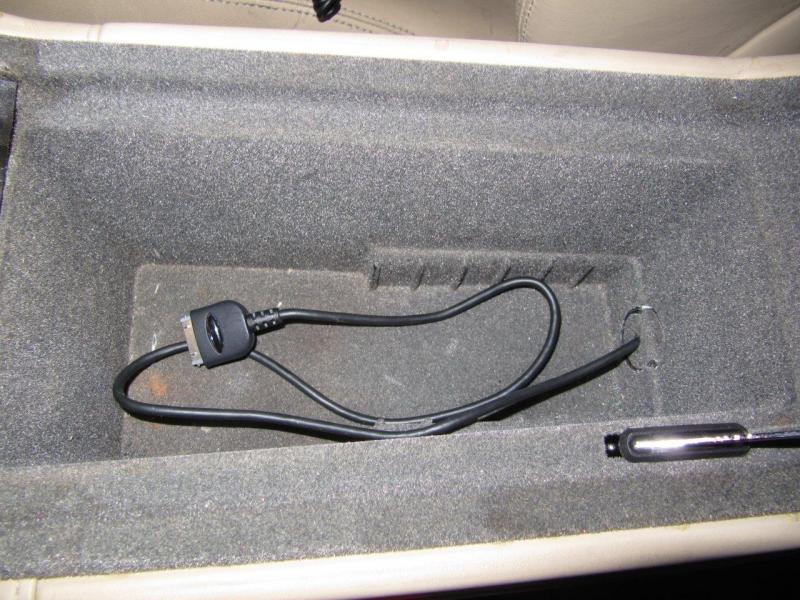

I also installed the iP-JAGCD iPod Adapter. The sound is CD quality and I like that I did not have to hack the CD player or the wiring. It took far longer to run the cable to the armrest than to install the adapter.
I removed the rear seat cushion, the seat back, the rear A/C duct and heater switches, and the center cubby under the arm rest. I snaked the cable down to the center of the footwell and then snaked it under carpet at the hump and into finally into the center cubby. The carpet was really tight and I used a pry bar to lift it up enough to snake the cable. The cable fits between the arm rest and the compartment with the arm rest closed so I can access the iPod when driving. Having the radio volume controls and iPod charging built in make this adapter a great solution
