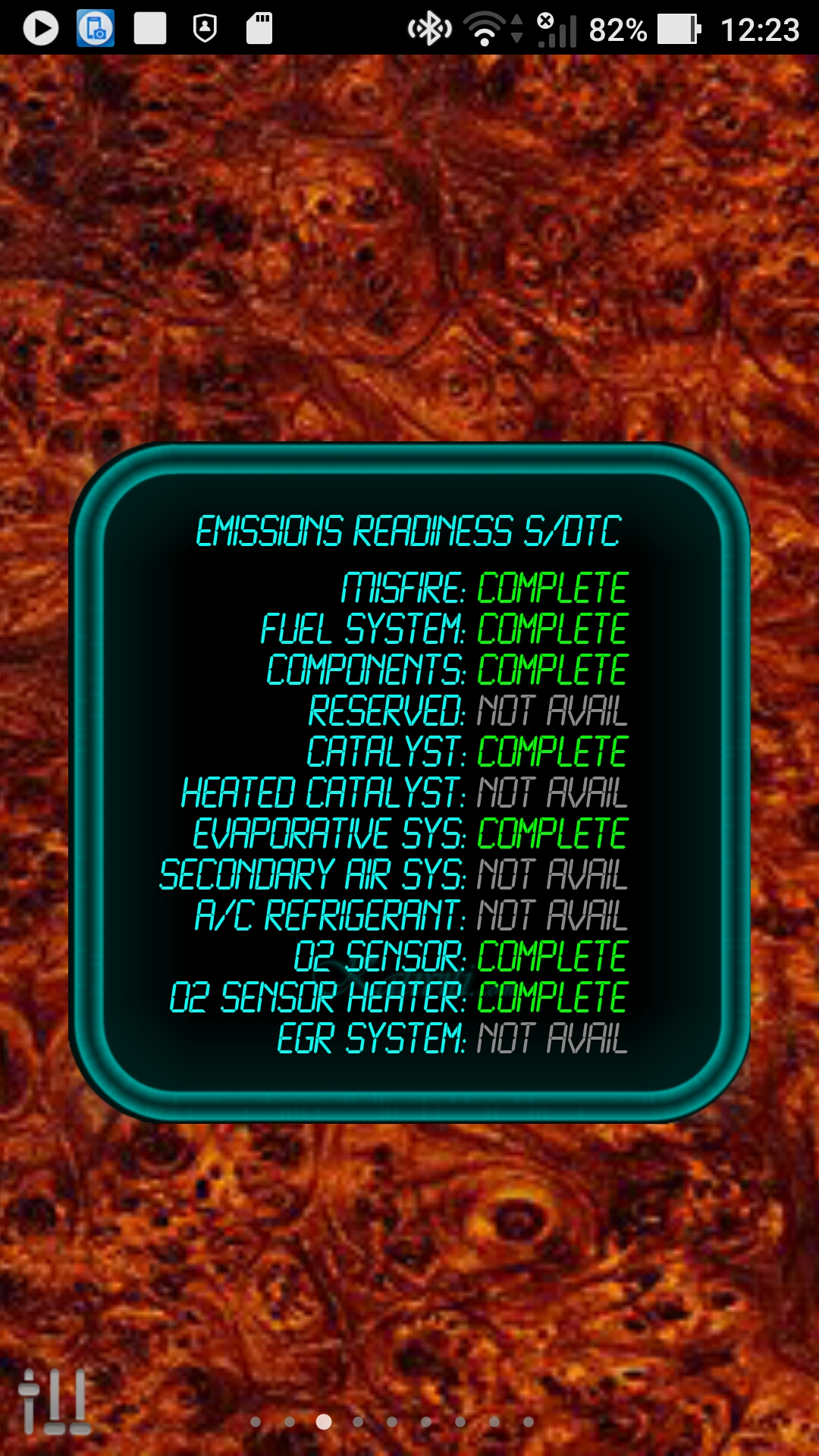

Couple of remarks:
1. The STFT is the immediate reaction of the ECU on a non perfect fuel-air mixture. You will see much bigger changes if you press the throttle, or go uphill.
2. The LTFT is more a balancer or an corrector, which is much slower, and corrects so to keep the STFT around zero. That is why you will need to check and report the LTFT's too.
3. Each bank has individual readouts for the exhaust analyses, so you will need to set the gauges for each bank.
4. I enclose the screens of my Torque Pro which are relevant for you, so you see what and how I am monitoring.
As you can see, the last 2 pages are gauges for the left and right bank.
Attached Thumbnails Bad Acceleration.-screenshot_20170204-122317.jpg   Bad Acceleration.-screenshot_20170204-122345.jpg   Bad Acceleration.-screenshot_20170204-122359.jpg   Bad Acceleration.-screenshot_20170204-122406.jpg
