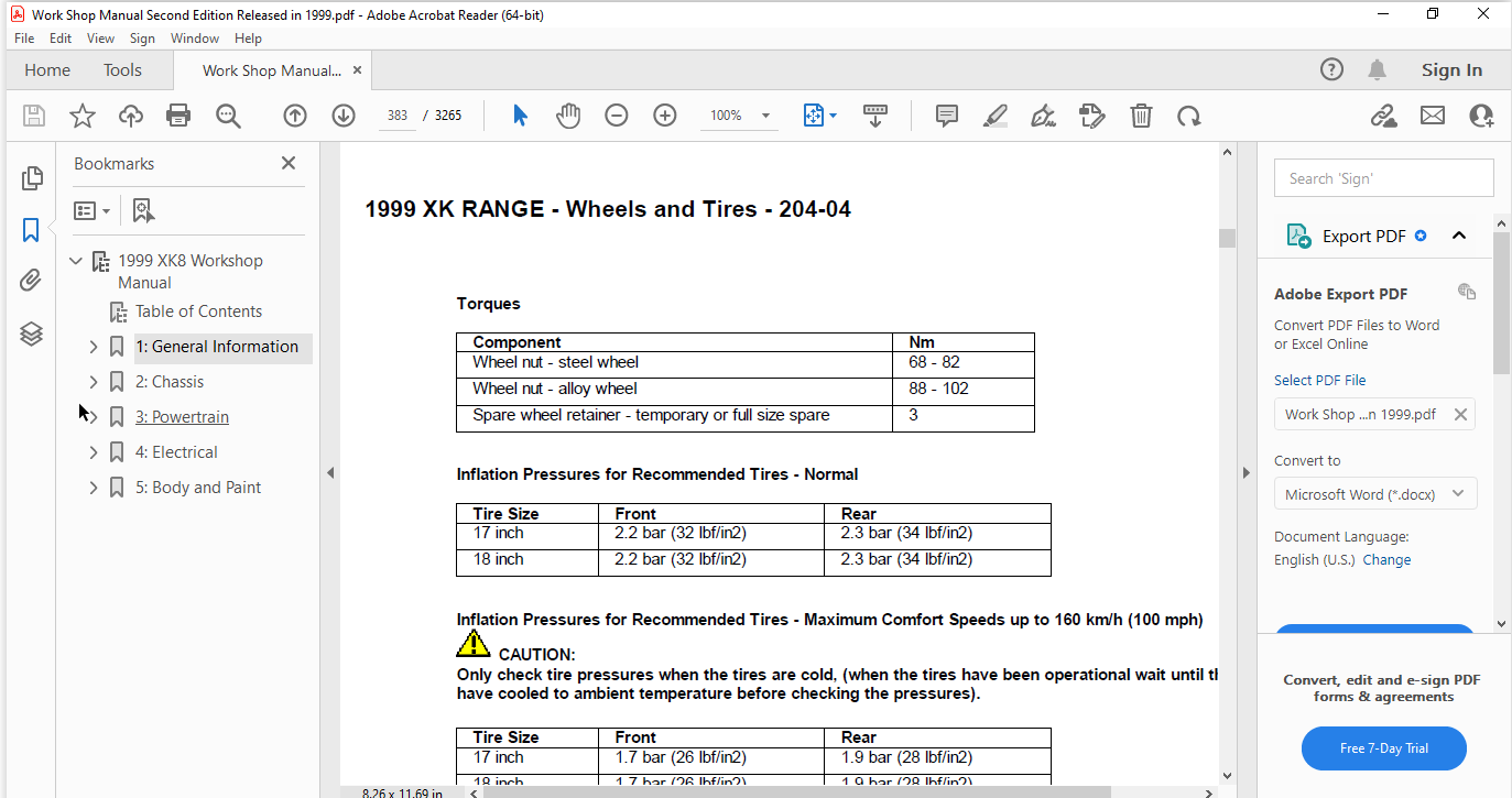

This is from the Shop Manual circa 1999:
Shop Manual recommendations for metal and alloy wheels
