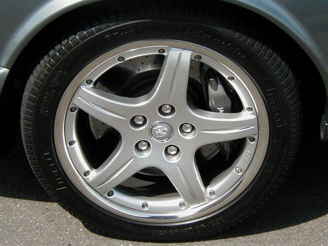

Hi TN8Shooter,
As I understand it, the performance package consists of
8.5" x 18" BBS wheels and Brembo cross-drilled rotors and calipers.
The rotors are 355mm x 32mm.
standard XJR rotors are 325mm x 28mm
standard XJ8 rotors are 305mm x 28mm.
those rotor sizes are from JTIS.
This is what the performance package (R Performance) Looks like.
Someone jump in and correct me if I missed something.
Thanks.
