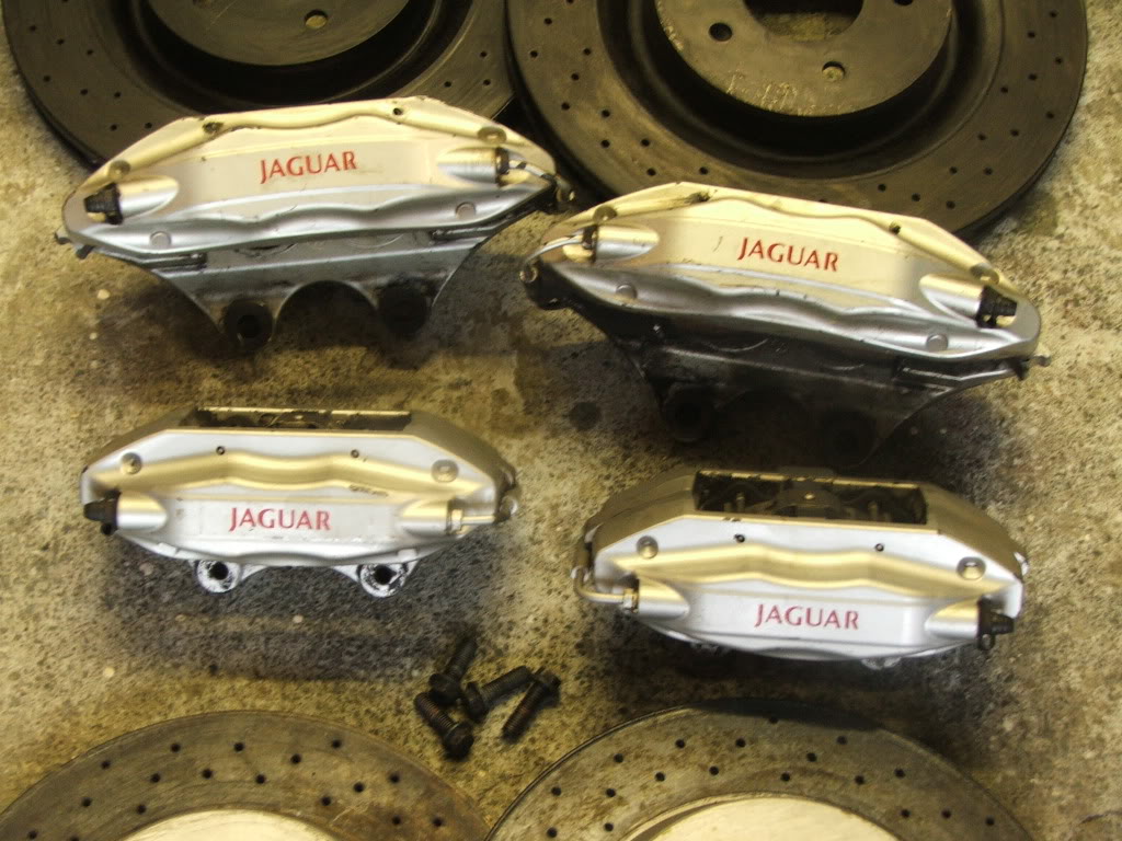

Sure, do your calipers look like these, if not, it's stock.

The fool proof way to see what you have is to measure the Dia of the front and rear rotors then cross reference them.
