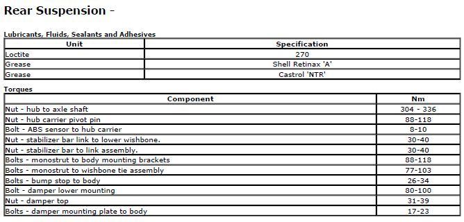

I experienced the same issue two years ago. Let me tell you being towed home is the best option. I ignored the grinding noise for a few days and ended up with a super wobbly rear end when accelerating. I had quite a lot of play when tilting the wheel horizontally and vertically. And when I changed the wheel bearing, it was almost fully disintegrated and came off nearly without using the shop press.
And by the way, the rear hub nut is torqued down with 270 Nm (200 lb ft). Not the easiest repair if you're on the road. That's quite the highest torque used for any component on the car.

Have ordered the new bearings seals, etc. Incredible that the axle nut costs as much as all the other parts combined.
200 ft/lb is a lot. On my Porsche 914 it is 217 to 253 lb-ft!

I was going to say, those axle nuts have an integrated (aluminum? brass? something softer) thread insert that makes them non-reusable for safety reasons, but it sounds like you're already on top of that. Even if it could be tightened up out on the road it could come loose again easily..
I'm kind of surprised the torque is less than the torque required for the crank pulley bolt. 375 Nm if I remember right. I guess you don't really want to crush the bearing races with those axle nuts.

The actual axle nut torque spec for the X308 is 304 Nm / 224 ft. lbs. to 336 Nm / 248 ft. lbs., so you need a torque wrench capable of measuring up to 250 ft. lbs.
