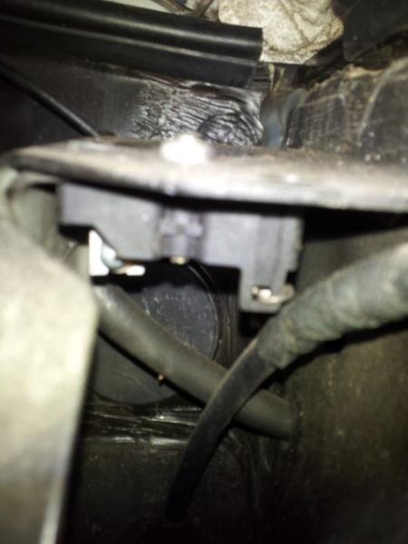

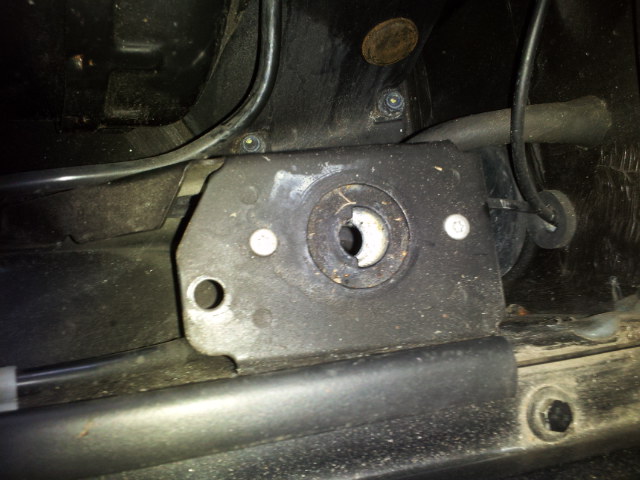

Hey Rik, you got me curious and whilst I was under the hood of mine today I looked at my hood latches so in the event of a broken cable etc I would be able to see what I needed to do to release it. Looks like my 99 has two large holes coming in from the passenger compartment footwells into the area of the latches. It is kinda tight, but in a pinch I could probably get something in there to release the latches. I will include a couple of pictures I took, maybe they will help someone else out someday.

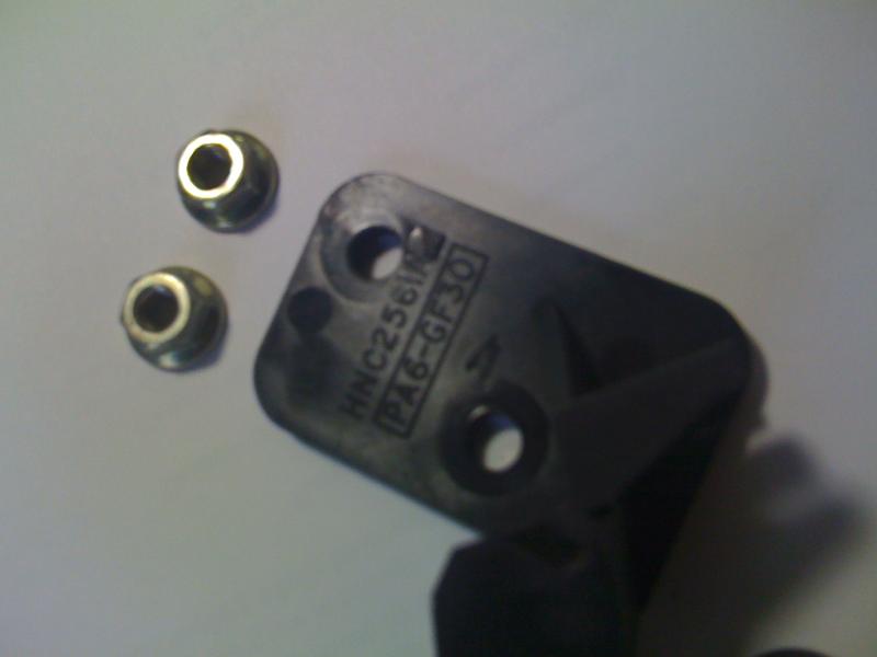

What I discovered once I had the latches off, was that the cable had not broken but it was falling out of its slot in the latch mechanism. So don't buy new cables before confirming your cable is actually broken. To temporarily prevent the cable end from popping out again, I used a short length of thin mason's twine to neatly support the cable end and keep it in place without being under tension. This works great and I can now release the hood from the cabin by pulling the cable with pliers. No more fishing under the wheel well, at least.
Removing the lever was next. I found that there were two 10mm nuts holding mine in place and they were really easy to remove thanks to Sean B.'s suggestion of pulling out the coin box (one screw and it slides out). With the box out you can see what you are doing and you needn't be a contortionist to get at the nuts.
So now I just need to find a replacement lever. I thought this would be easy but so far today I have not found a match online. It is marked with Jaguar part #PA6-GF30 (left hand). I suppose the dealer will have one if all else fails. When I get it sourced I will post the details.

Thanks - I was using the wrong part number... when I tried HNC2561AC I found sources galore. I will checkout Coventry West - it seems to be about $25 OEM at several places online.
