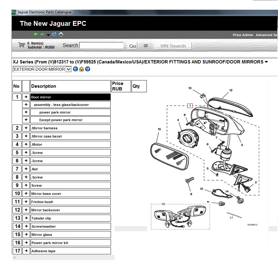

Old Apr 6, 2014 | 10:20 AM
Likes: 17,016
Basically, any X300/X308 mirror from 1995 to 2003 will fit any X308 but there's a number of variations in specification to be considered:
1. powerfold or non-powerfold
2. heated or non-heated
3. auto dim
4. flat or curved mirror glass
The colour of the backcover is not a problem as these are secured with round spring clips on plastic pegs and can be popped off and switched over.
