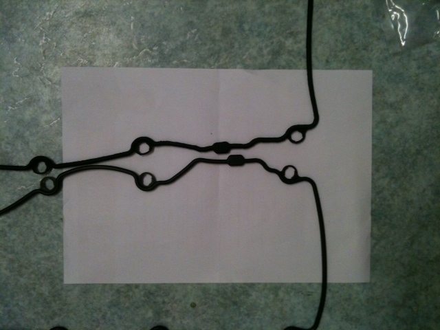

Have a close look , the only difference seems to be the placing of the square parts on the gaskets.
Here's a quick pic of mine

I'm now thinking maybe the parts are correct. I've already replaced the right bank cam cover so I can't compare the the two I have got. I think I will go ahead and remove the left bank next week and accept that I may have to wait for a replacement gasket if the part is wrong. BTW - the reason I am doing this is that I have just bought a 2000 VDP and I need to check the tensioners. The right bank is ok - the tensioner has already been done. I could leave the left bank and make the assumption that the tensioner must have been changed as well - I just want to be sure. Thanks for sending the pics - they are helpful. BTW BTW - I see you are in the Netherlands - love Amsterdam - I'm a Brit, so I am familiar with your country.

The pics have it. I have just been into the garage and draped the gasket over the top of the left cam cover and I reckon it will fit - the part looks to be correct after all. Thanks again.
