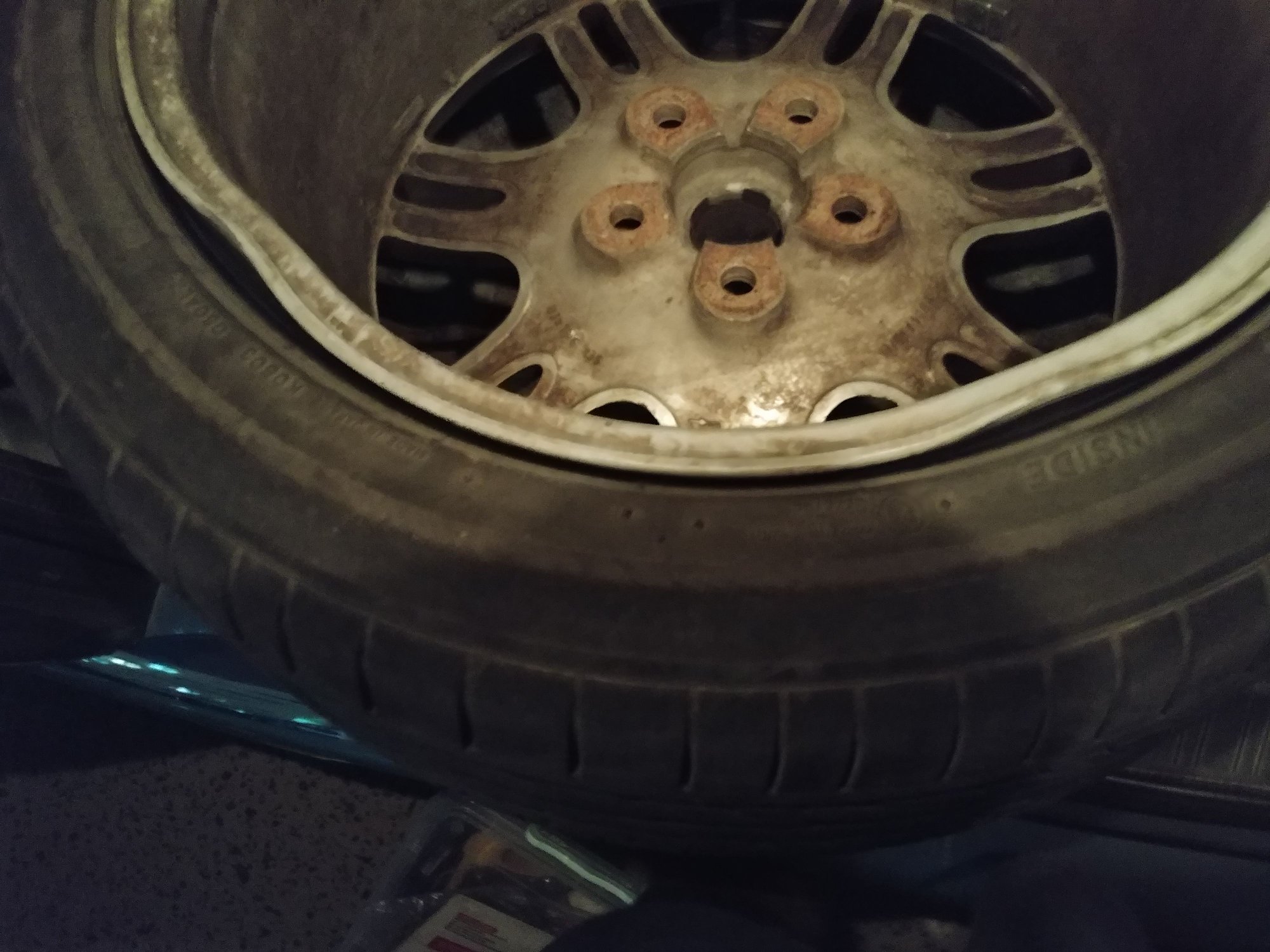

Hi guys . I bent my wheels I was driving my car normal speed 40mph then couldn't avoid the hole in the street so tire became flat and wheel Bent now can this be fixed?

i think that bump can be pounded back into shape and the tire re seated, you may want the check its balance. I've seen worse.

I'm with jeff xj8, I've seen, and straightened much worse. The way I judge whether Aluminum can be straightened, is to look at the areas where it has bent. If you can see cracks / splitting of the Aluminum. Then it's to far gone, to simply pound it back into shape. That will require professional reconditioning. But what I see here shouldn't be a problem. Hope it helps.

A 2x4 and a BFH will straighten that out.

Can't see any cracks it's just the 2 bents I will go to tire shop hopefully get fixed asap. Thanks

aluminum has no memory, a pro might get done but don't get your hopes up. IF you straiten it out chances are it will crack, thats not a hard wheel to find,i would replace it. cheaper to replace than paying someone to try to fix it.

Fixed it already I wouldn't say it's like the factory work but now the wheel have no bents and works fine .
