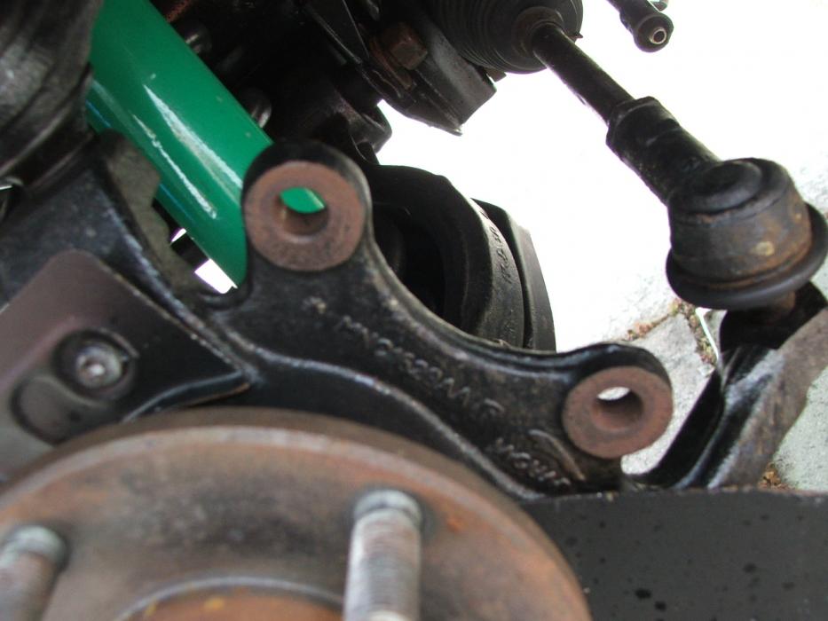

First picture is the kit your looking for, second picture is the x308 front axle they bolt to, these are the holes Luc refered to for cutting a thread to bolt the calipers up..
The earlier version Luc has fitted do not have these bolt lugs cast onto the caliper, they're bolted to adaptors then to the axle. If you buy the early type you can buy Luc a drink for adaptor patterns.
Last picture is the Alcons fitted to the rear of my XJR100. They also require adaptors. Have you a picture of the calipers you have? Don't guess about the brackets, you're in the USA were ANYTHING can be made in billet steel. My adaptors cost roughly the same as Luc.
