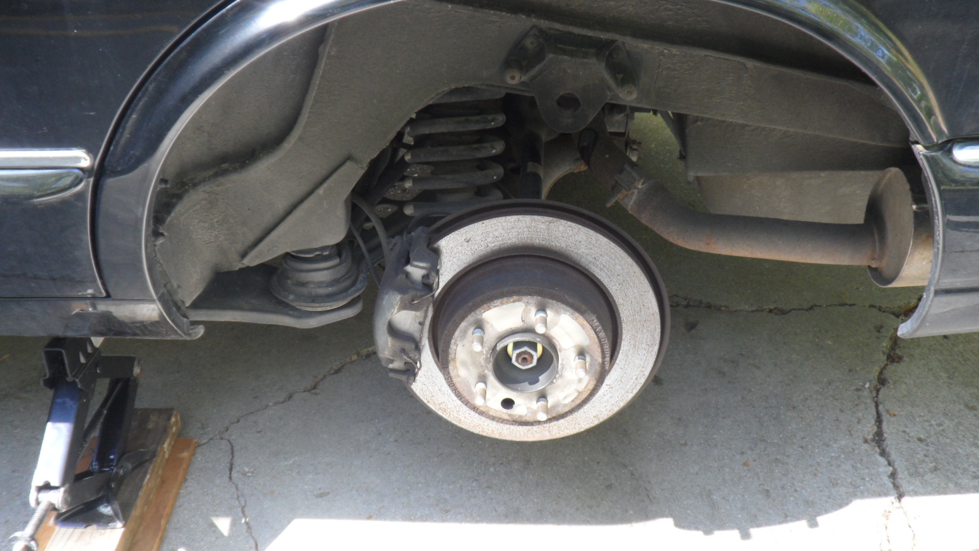

My 1998 XJ8 Landen Plas w/the 4.0 V8 did the exact same thing about a month ago. I was driving down the highway and the vehicle simply lost power, shut off. I coasted to a stop, waited a few moments, and it restarted. It did the same thing about four more times on the way home. (about 30 more miles to home.) I bought the fuel filter for $12.00 (US) and went to task in trying to find the the fuel filter, which was quite the adventure in itself. You may already know where it is, or may have already changed it before. I'll post a few pics for those that don't know, or haven't changed theirs before.
My 1998 XJ8, Drivers side. You will be using the jack and will be removing the left rear wheel. Be sure to make the car safe to work under, ie: Jack Stands, etc.
With the wheel removed:
If you'll look to the right, (towards the rear of the vehicle), and up, above the Half-shaft, you'll see the filter wrapped in a brace.
A better view:
Another quick note: The fuel filter has "IN" and "OUT" sides to it. My replacement wasn't stamped on the ends like the old one shown in the pic. It was stamped on the side of the filter with an ink. And if the leaked gas gets on that stamp, it will run and disappear on you. Just compare the new filter ends to the old filter if that happens and mount it correctly.
This is a pic of the filter and the brace. Once the fuel lines are loosened and removed from the fuel filter and any spilled fuel is contained, loosen the center bolt of the fuel filter brace. If the filter is stuck to the "vibration dampening" foam rubber, it may be needed to remove the bolt. That wasn't the case for me. Mine was free after loosening the center bolt and the fuel filter slid right out of the brace easily. (See pic pointing at center bolt) Removing the entire brace is not needed. The "vibration dampening" foam rubber is attached to the brace, not the filter. The filter will slide right out.
Don't forget that there may be a lot of fuel pressure still in the line, depending on how long it's been since you've turned on the ignition key, or driven the car. Have lots of rags around to contain the fuel that's lost. There has been discussion about using a valve in the engine compartment to relieve the pressure, if that's the route you want to take.
As a side note, the filter is a Fram Fuel Filter #G3727, available at Walmart and any other reputable auto parts store, since it fits many, many models of GM cars and trucks. About $12.00 (US)
I haven't taken pics of the gas that came out of my filter. I could not blow through the filter, at all. The gas was dark brown with lots of silt and debris. I took a 12 oz. clear plastic water bottle and slipped it over the line coming from the fuel tank and had a 2nd person turn the ignition key on and pump fuel into the bottle, which I was very glad that I did. I was amazed at how much debris came on out of the line that was backed up behind a very plugged fuel filter. At least I will start with a clean line now. I'll try to take pics of both of those bottles, since I saved them, and post those, as well.
A better view:
firstchoice,
Thanks for the phototutorial!
BTW, it's easy to relieve the pressure in the fuel system:
1. Remove the gas filler cap to relieve any pressure or vacuum in the tank;
2. Remove the fuel pump relay(s);
3. Start the engine and let it run until it dies. The fuel system is now depressurized. If the engine won't start, the fuel pressure regulator (FPR) and/or fuel check valve are probably no longer holding pressure.
Don't forget to reinstall the fuel pump relay(s) after you've changed the filter.
Even with the system depressurized, there will still be a little fuel loss when you disconnect the pipes from the fuel filter, so your tip about having some old rags at hand still applies.
