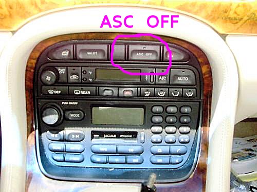

A little correction. It's ASC OFF. Check the picture.
This ASC means Active Stability Control - it's a special system that stabilizes the rear side of the car when the tires are drifting, or the car is over steering, or it's slipping (on ice, snow etc). The system is playing with the brakes (most of all) and it's reducing the acceleration when it's necessary. By default the ASC is activated every time you start the engine. If you want to turn it off, just press the button ASC OFF - if the red light on the button is on - than the system is disabled.
It depends on the variant.
There are some markets where there are more buttons on that row and the only marking is "TRAC" without any on or off notation because the button is much smaller.

Yeah, mine has the seat heater buttons on that row as well as the "TRAC" off button. But if you disable the TRAC or ASC I believe it does the same thing and turns them both off.

There are 2 versions of traction controls, the basic one ( ASC, Automatic Stability Control ) that, using the ABS sensors as input, reduce power and power only, to the rear wheels by a combination of: 1/ throttle, 2/ ignition and 3/ fuel.
The most advanced system, ( TRAC) add the possiblity of actuating the brake on the spinning wheel.
Obviously the labelling on the switch as nothing to do with the size of it but rather with wich system the car is equiped.
TRAC is a much,much better system:
Let say that you have 1 wheel on snow/ice and 1 wheel on dry pavement:
With ASC you will go nowhere, with TRAC, as in a locking/limited slip rear differential, the spinning wheel will not spin and the power will only go to the wheel that has traction
Plums: My 01 XJR has the wording "off" on the switch and the switch is the small 1 since i have heated seats. Are you sure that yours don't have the word off?
