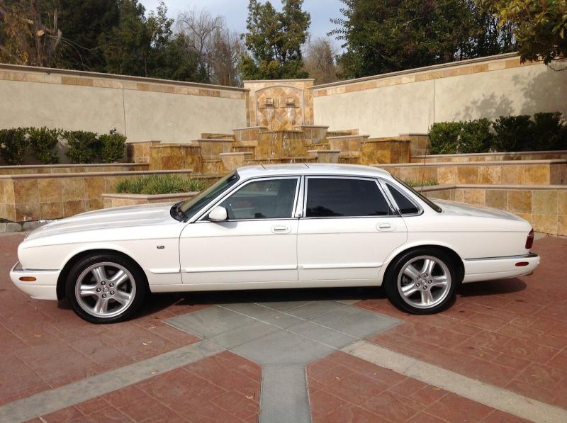

Hi everybody
I'm coming from the German car world into the Jag world and its purchase time so I wanted to get opinions on three cars and see what the experts think. First, a little about me: I'm needing a larger car because my wife and I just had a son and my 3-series coupe isnt cutting it. I live in Sherman Oaks and drive into Hollywood for work everyday. It's 11 miles and could take 15 minutes or 45 minutes (SoCal just has different levels of traffic hell). I'll probably drive the car 6000 miles a year give or take 10%.
In no particular order:
Car #1 2003 XJ8 Sport - $7200
128k miles, new tires, rebuilt transmission at 125k, new fuel pump and filter, 2 month old battery, new rear door actuators and a new cup holder
Car #2 1998 XJ8 - $6995 with shipping and warranty to SoCal
Jaguar XJ XJ8 | eBay
Service unknown, but it comes with the warranty below:
Car #3 1998 XJ8 - $6500
Jaguar XJ8 Green | eBay
Timing chain, chain rails and tensions have been updated
Love to hear some opinions. Also, with the two older cars is there a way to upgrade the headunit to a cd player or integrated iPod/iPhone player?
Thanks everyone!

Hi:
Tough choices… General wisdom is that the newer the x308 the better because of the tensioners and strengthened transmission. But that doesn't guarantee anything, as even this '03 has had the tranny rebuilt. I would worry, as i do with my '98, that the transmissions on either of the other cars will eventually go; so you should probably begin setting money aside for that just in case. Otherwise, option 3 seems like 'best' to me due to the tensioners. But after 16 years, and low miles, you will undoubtedly be spending the first year or two fixing the little stuff that pops up…

Too easy. #1: five years newer, better engine, tranny, stronger suspension. May need plugs, brakes, and shocks, maybe water pump, tstat, and hoses, but these are normal maintenance items. But the other two will need these as well.

Here’s my opinion in addition to the other members input provided:
1. White XJ Sport w/ Penta wheels, this is my preferred color/style combination. 3k mls on a newly rebuilt tranny and recently replaced fuel pump will give you some peace of mind. New set of 18” tires is a plus. 128k mls is something to consider on the overall condition of the vehicle.
2. Buying a car sight unseen is a gamble but others had great success, IMHO. 5 yrs. drive train warranty makes it attractive but it depends how reputable the company providing it.
3. 66K mls with upgraded time chain tensioners. If the overall condition is better than the XJ Sport, I would possible get this one.
There’s 2003 XJ Sport in Asuza: one owner car with 73k mls. I got a call from the owner couple days ago and he’s willing to let it go for $7k from initial asking price of $8.5k. Here’s the link: 2003 jaguar xj sport sedan

The 2003 by a country mile.
The 1998's have the AJ26 engine and the 2003 has the AJ27 engine. Same basic block, but the engine management system is completely different.
All the perishable rubber and plastic is five years newer ... including hoses.
The 2003 definitely has the metal upper tensioners unless some fool replaced them with plastic.
The 2003 also has the upgraded metal shim head gasket instead of the composition gasket used in the 1998.
