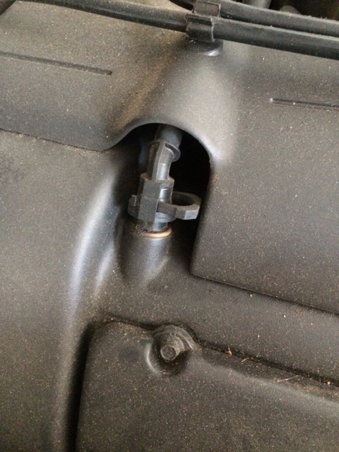

Here is a picture of the tool on my XK8. I found that in a pinch a pair of needle nose pliers will work. You put them in and then pull the handles apart rather than clamping. You just need to push the 2 ears outward. Also, check the O-ring that is inside the fitting and make sure it is still soft. If it isn't change it out before reinstalling or you will have a leak.

Vern, I've been using the screwdriver method to remove these fittings. I didn't know the tool was already on the car. I learn something new about Jaguar's on this forum everyday. What a time saver. Thanks again.
