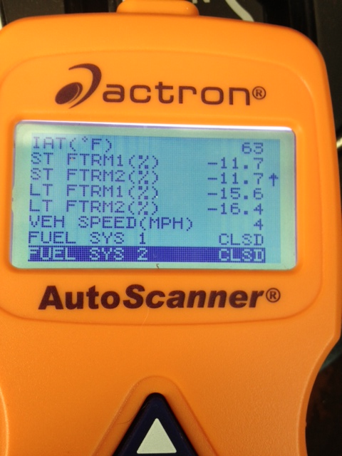

photo 2,6 and 3 are OBD readings at idol just now.
photo 4 and 5 are freeze data readings when the code was logged this morning. Long and short trims way off. While driving home the live data at 50mph for stft on both banks at +3 to 5.5 and ltft at -12 to 13or15ish. At 35mph st. is around +2 to 3, lt is at -5-7 ish or a bit higher.
It seems that it generates the code at or near idol while driving in stop and go, in town situation with the engine at operating temp. Although it produced the codes once upon a morning start up in the garage.

Don't pay too much attention to the fuel trims right at a cold start. At that point they are not being used to fuel the engine and the O2 sensors are not in play because they are not at a working temp themselves.
With your data, it's clear you are getting fuel in that shouldn't be there, or the MAF is over reporting air so it's over fueling that way. I think the first thing I'd want to check is the fuel pressure regulator at the rear of the RH bank fuel rail. There is a vacuum hose to it from the induction system. Start the engine cold and let it run for about 30 seconds. Shut it down and immediately pull the vacuum hose off the regulator. See if the hose is by chance wet with fuel. If the diaphragm ruptures it can send a load of raw fuel into the induction system and cause the rich faults. If you can get hold of a hand vacuum pump, you might apply vacuum to the regulator and see if it fails to hold any vacuum. That too is a problem.
If nothing turns up there, you might have to concentrate on the MAF sensor.
