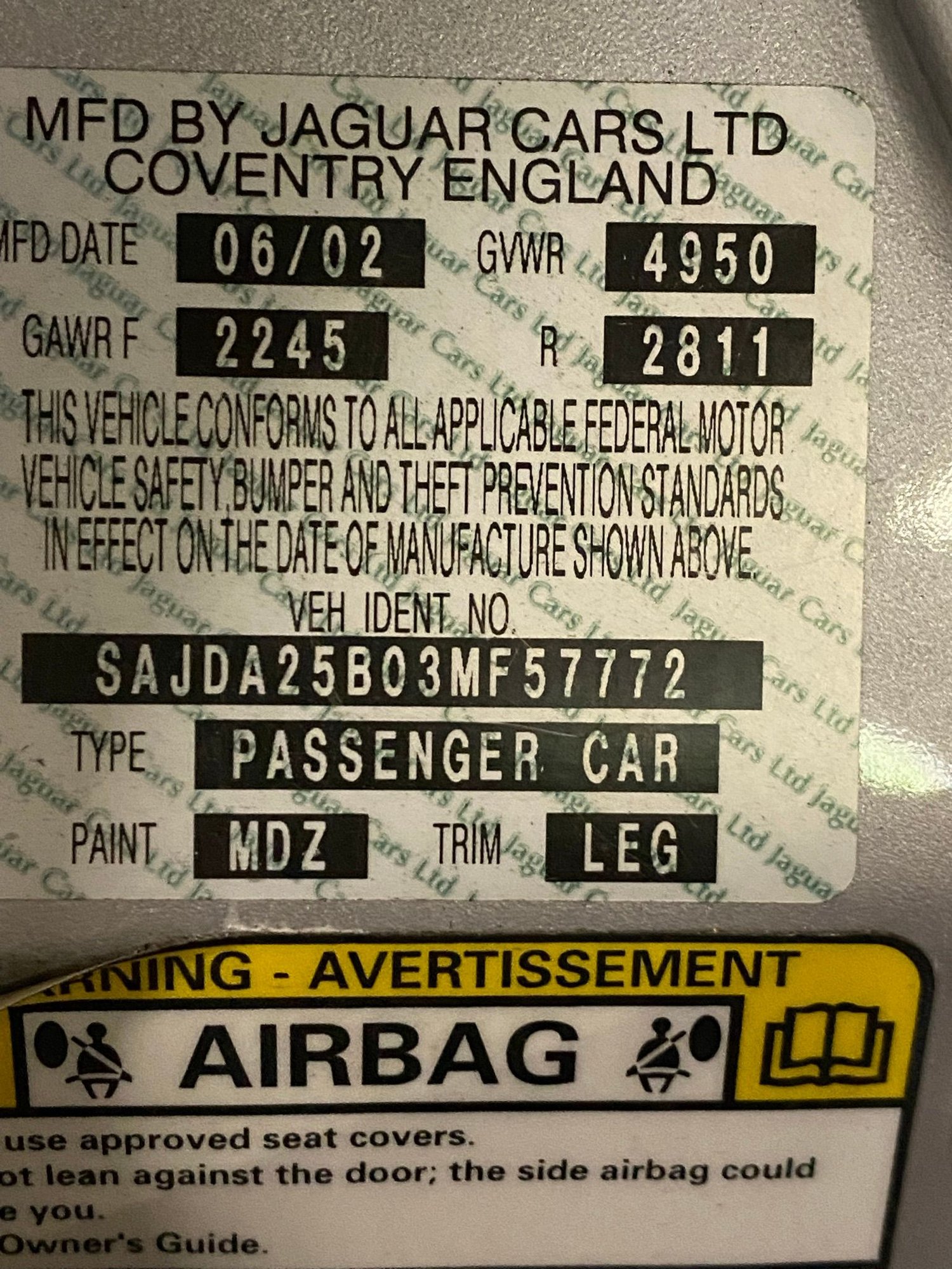

Here is the vin. Thank you
Terry

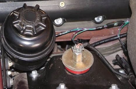

if you look at one of the front shock towers, under the black plastic cap, and see a cable connected to the shock shaft (see pic), then you have adaptive suspension.
Green shocks mean sports suspension, black means comfort. Both have adaptive and non-adaptive versions.

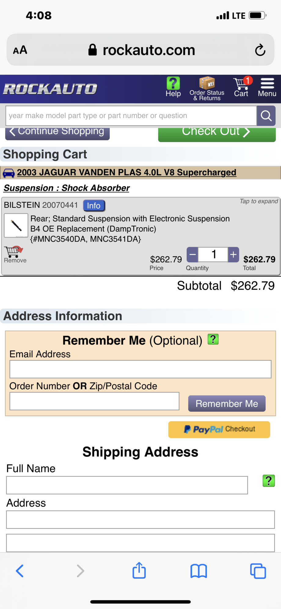

Hi guys, my car does have the adaptive suspension, so would this be the correct rear suspension to buy ?
Old Nov 7, 2021 | 04:18 PM
xalty's Avatar
Joined: Dec 2019
Posts: 3,695
Likes: 1,222
yes

Thank you for the reply. I am about to order a set of rear shock for a 2003 VDP/SC with adaptive suspension from Rockauto, do I need to order other parts, hardware ,bushings or shock l mounts ? I will not be doing the job, RMB auto in North Hollywood will be doing it
Bilstein parts # 20070441
Thanks
