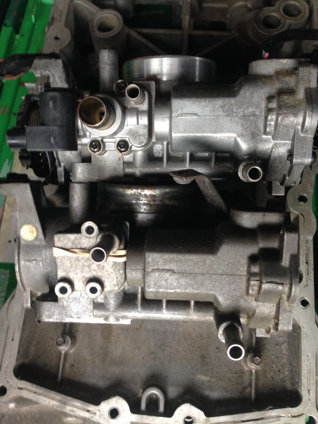

Here is the TB on the car ('03 XJR):
And here is the one from my parts car ('03 XJ Sport)
Both are definitely wet, and in fact I clearly recall a coolant leak from the right-hand hose on my car when I got it... I bought the hose from Gaudin!
From the pictures it looks like the position of the left-hand hoses are in different locations - the XJR picture is from a while ago... I will double check that this evening.
I'd be very interested to see a different R TB... all the ones I've been able to find online are unclear as to their source, or they're from an angle where the ports are not visible.
Really appreciate your help on this....
Edit: Oh, yeah, you wouldn't happen to know the thread size for the TPS screws, would you? Looks like maybe M4 or M5? Seems I'm going to need to find one.

I'm ring rusty! it's not coolant lines as both SC and NA have them, it's the "Air Assist" line from the NA throttle body that needs the SC plate as seen in my pictures.
Attached Thumbnails Clicking - Throttle Body?  Now Failsafe Mode P1229-img_0636.jpg   Clicking - Throttle Body?  Now Failsafe Mode P1229-img_0638.jpg   Clicking - Throttle Body?  Now Failsafe Mode P1229-img_0639.jpg   Clicking - Throttle Body?  Now Failsafe Mode P1229-img_0640.jpg

Okay, that's *real weird* - check out my pictures above... the NA version I have has *an* air assist port! It appears to be different from the one on the car, but it's not a big blank spot like yours. Maybe a running change? Very weird!
Old Mar 22, 2017 | 12:22 PM
Sean B's Avatar
Joined: Oct 2008
Posts: 4,880
Likes: 1,431
From: Sunny Southport UK
In the first picture lhs the SC body is stripped of both TPS/TPPS, but the main item is the part with the elastic band round it the air assist port blanking plate. The TB on the right is an NA unit with air assist plate and controller.
SC = no air assist
NA = air assist
Old Mar 22, 2017 | 12:55 PM
thesameguy's Avatar
Joined: Jul 2013
Posts: 213
Likes: 41
From: Sacramento
Yep, understood - but look at the pictures:
Mine - pulled from an '03 XJ8 Sport:
Yours - from IDK.
My NA TB *has* that air assist port!
Old Mar 22, 2017 | 05:25 PM
