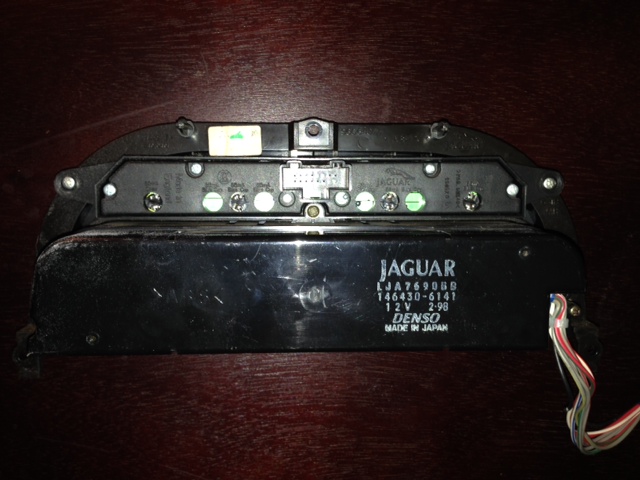

There's 2 twistloc bulbs on the circuit board that require replacing, you can do this by upgrading to blue led's - the original incandescents have blue rubber bonnets that fit over the bulb - the issue here is a blue screen and aqua/green everything else. I did a conversion a few years ago to all led....
The original bulbs are available from the Dealers - I can't remember the part numbers sorry but a thorough search on here might pull them up.

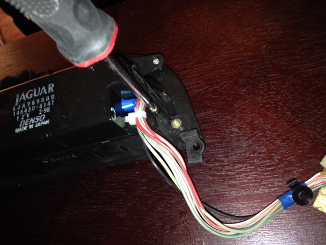

To access them you need to remove the black plastic cover on the back of the unit, a few pozi screws. Then locate the bulbs undo replace with the bonnets removed and installed off the old bulbs.
Be gentle with the wiring, this unit connects to the CanBus.

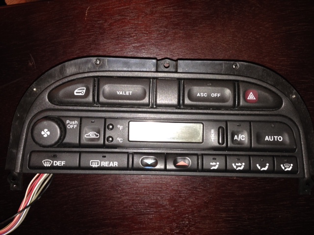

Here's some PICs of me doing this. Thanks Sean for pointing me in the right direction.
