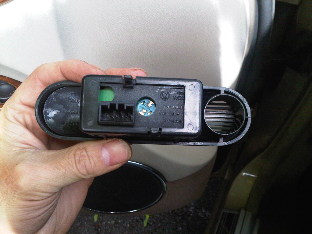

Pry up from the inside where the change holder was. Then brute force unfortunately. It's just plastic spring clips that hold it in.

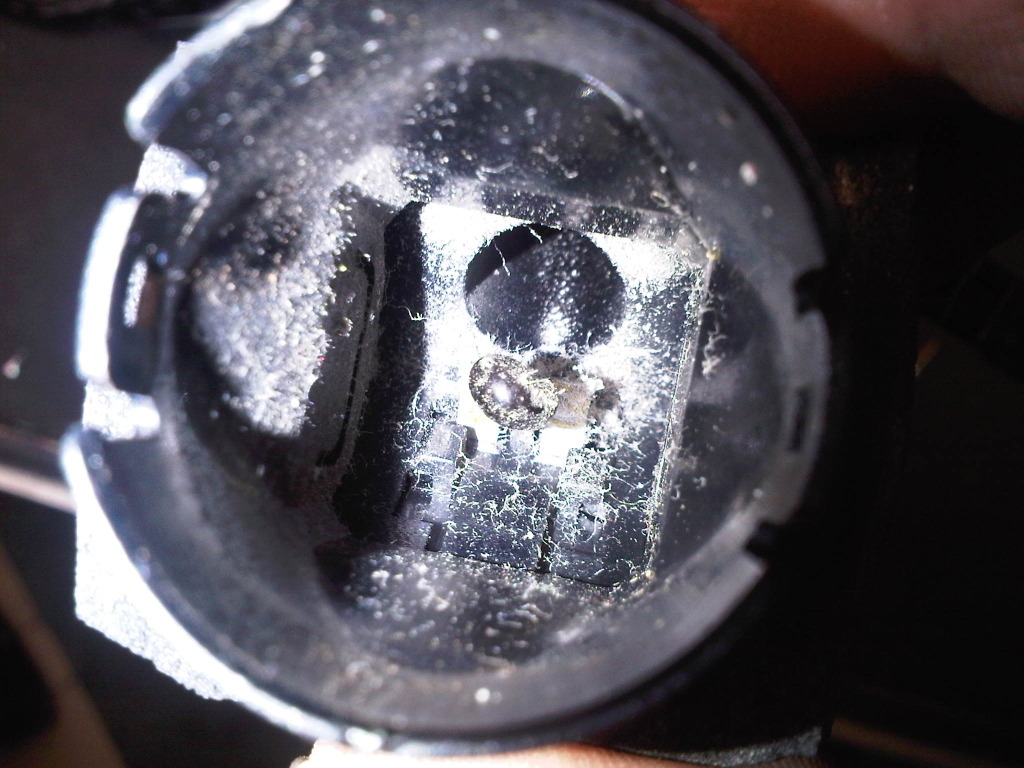

The temp sensor is in that piece, which is connected by a rubber hose to the fan.

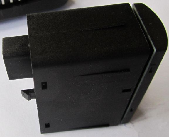

New photos on Trunk Release Panel removal and view of in-car sensor (in the dash).
Photo of the rear view of the removed panel shown separated from the trunk release button (also rear view of the button) - to remove the button component part, you need to push it (from the rear) out towards the front of the release panel

Next Photo shows the botton locking latch on release button component part.

Next photo shows the corresponding locking latch on the trunk release panel (on left part of photo) that matches up to the latch on the button component.

Here is the photo of the In-Car Temperature Sensor (shown in dash - I did not try to remove it)
There was only a slight amount of dust in the socket housing that has the sensor it. I did use a vac/blower to blow the dust out of it.
