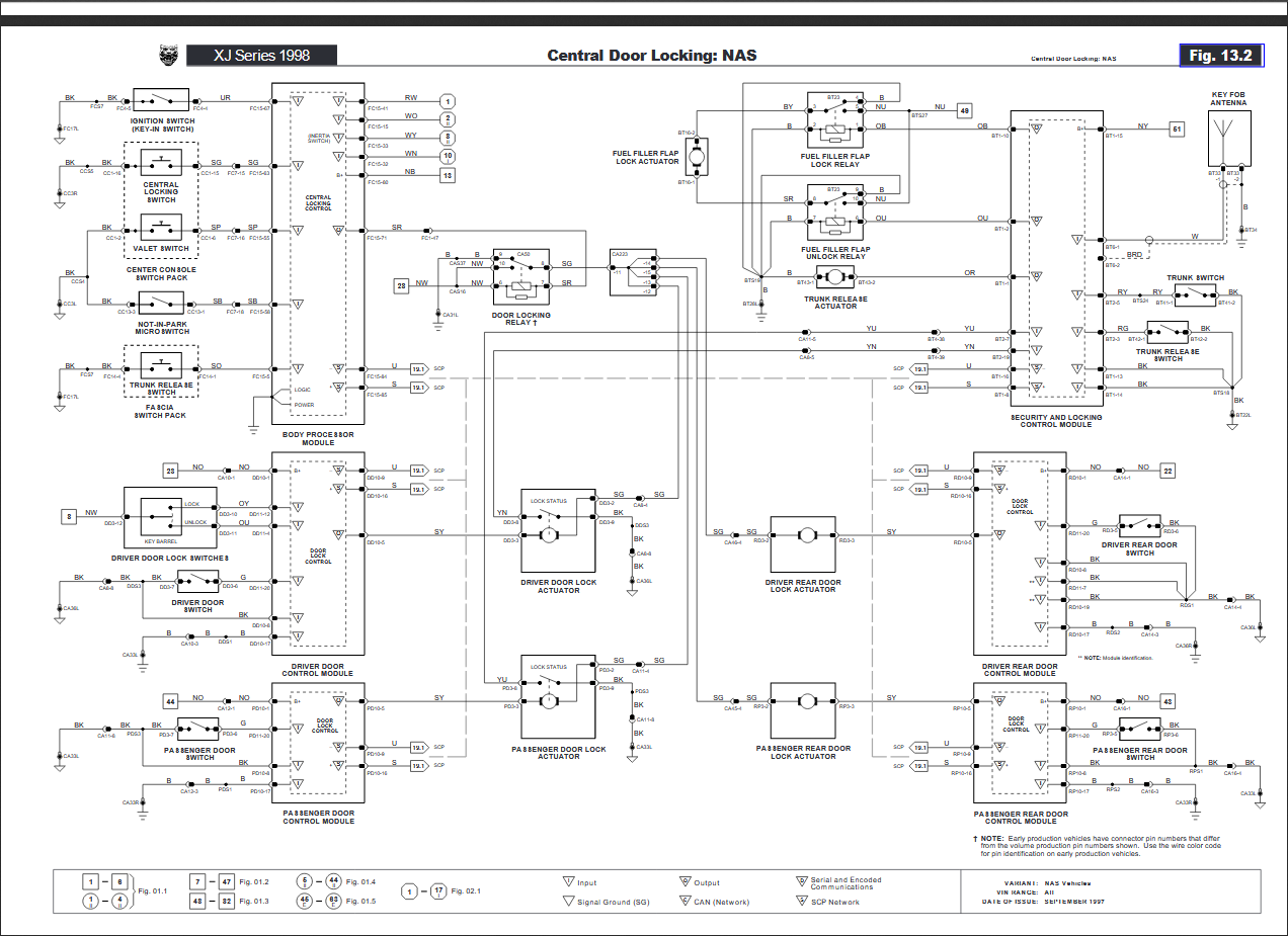

Here's your armrest electronics.....they may have simply not finished the secure connection of them...check that.
