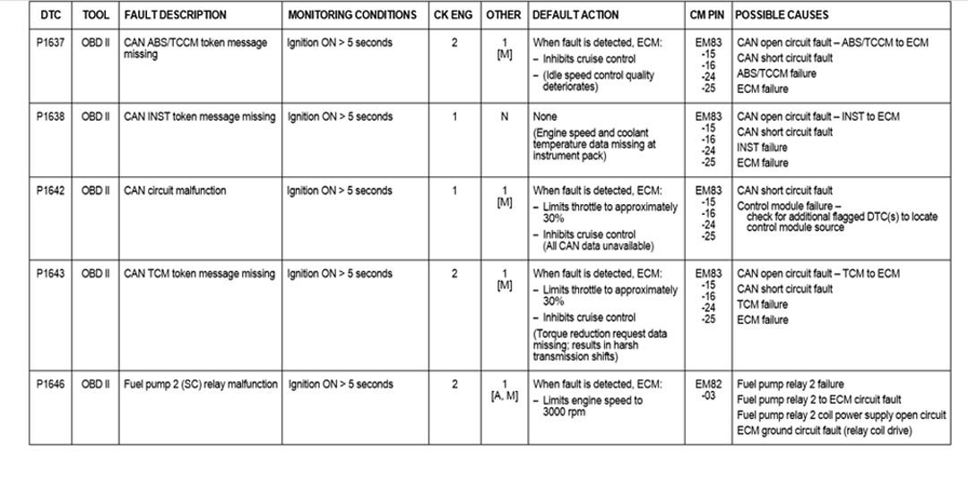

I'm getting a p1646 ecu 11 error message on my diagnostic tool.
Old Jan 4, 2020 | 05:23 PM
Carnival Kid's Avatar
Joined: Jan 2018
Posts: 1,841
Likes: 1,020
From: Redding CA

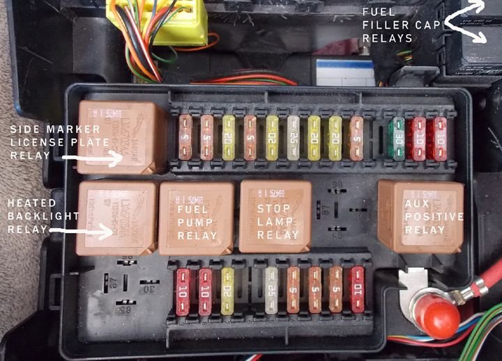

Sounds like it could be well true because it seems to to hesitate when driving and putting foot down. It seems to be getting worse also. Sometimes it seems like it wants to stall when stopping. Would the relay just not fail completely than slightly ?. Also do you have any idea where I would find the fuel pump relay ?. Many thanks.

I have to agree that I would think the relay would either work-or-fail.
Here's a pic of the relay location, in the trunk, next to the battery. Simple to replace and worth a try.

According to the Diagnostic Trouble Code Summaries for the 1999 AJ27 engine, the P1646 code does point to a problem with the A Bank/Bank 1 upstream oxygen sensor or its electrical circuit: Your normally-aspirated 1999 vehicle has only one fuel pump, so you do not have a Fuel Pump 2 relay to trigger the version of P1646 that relates to the 1998 supercharged vehicles.
You can download the DTC Summaries for your car at this link:
Jaguar AJ27 DTC Summaries 1999
