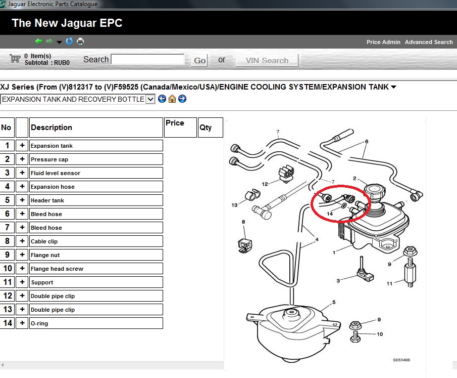

Check that the expansion tank is connected to the overflow properly:
https://www.jaguarforums.com/forum/a...nsion-tank-jpg
Hi all-
Thanks for the input, I appreciate it! As an update, I've double checked the small tubes going to the resevoir and they're hooked up correctly (as according to the link rj237 posted). On the way home yesterday it overheated so I'm back to the drawing board. Here's where it stands:
New water pump - check
New t-stat - check
Checked resevoir hoses - check (they cross as per diagram)
