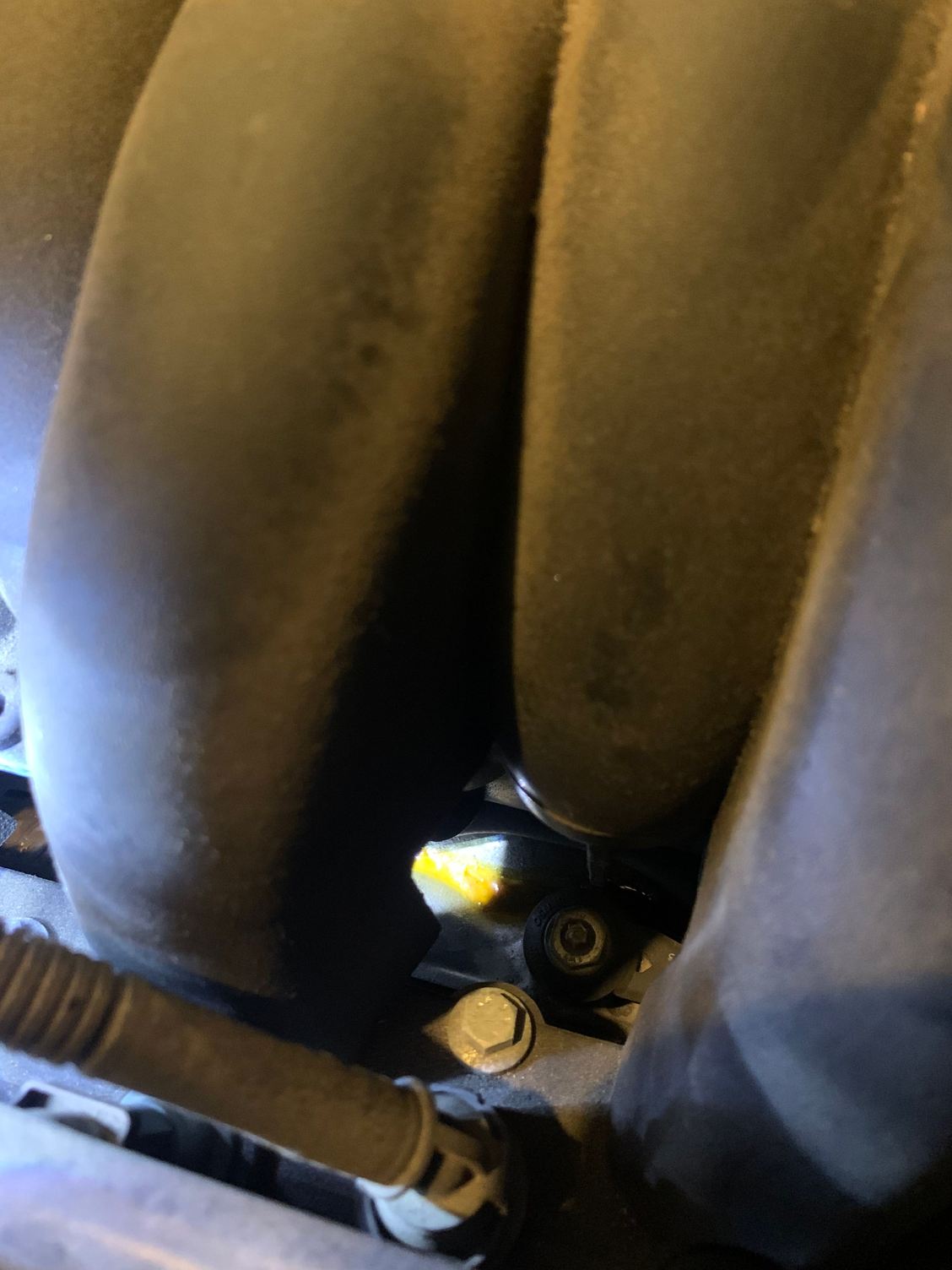

2000 xj8 vdp L
i have a coolant leak, but cannot see where it is coming from.
I had a bad leak on the heater return hose, which I spliced since it looks like a pain to replace.
after the system is pressurized, maybe 5 minutes, I have another leak.
I went out at 5 this morning an added UV dye, but I cannot see where it is coming from. It’s on ramps, so I’m sure that is running from somewhere like mid engine. It is currently dripping from the transmission I think. So something above and forward of that should be where the leak is.
the origin is not visible from above or below.
is this the dreaded valley hoses that I’ve seen mentioned?
all the hoses look original, so I’m sure that they need to be replaced here soon, but I’m physically disabled and don’t have much money; so I need to fix this myself before it gets much colder. We are already having hard frosts. Sorry, my pills make me ramble a bit…
the posts that I read about valley hoses is a bit beyond my expertise, but the heater return hose seems to be one of these.
the part that I spliced was a bit dry, and had stretched to nearly 1” ID, while it should have been around .75 I think. I spliced it with a .75 ID, and it seemed to fit the attachment correctly.
so I’m guessing with that leak fixed, another part of the hose cracked under pressure?
before I start removing the top half of the engine, I guess that I’m looking for two things.
first, does this scenario sound like it’s another part of the heater return hose? Since I know that that hose is not in good shape and I cannot actually see the origin of the leak.
second, is there a write up for removing and replacing this hose for dummies? I really need pics as well as written directions. The post that seemed to be most informative that I could find really seemed to jump quite a few steps. For example, first was a picture of the engine initially, next was one down to the manifolds. Think there was something missing lol. I’m sure there is one, or to a related model, but I’m not finding it.

The heater return hose under the front of the inlet manifold is a known failure point.

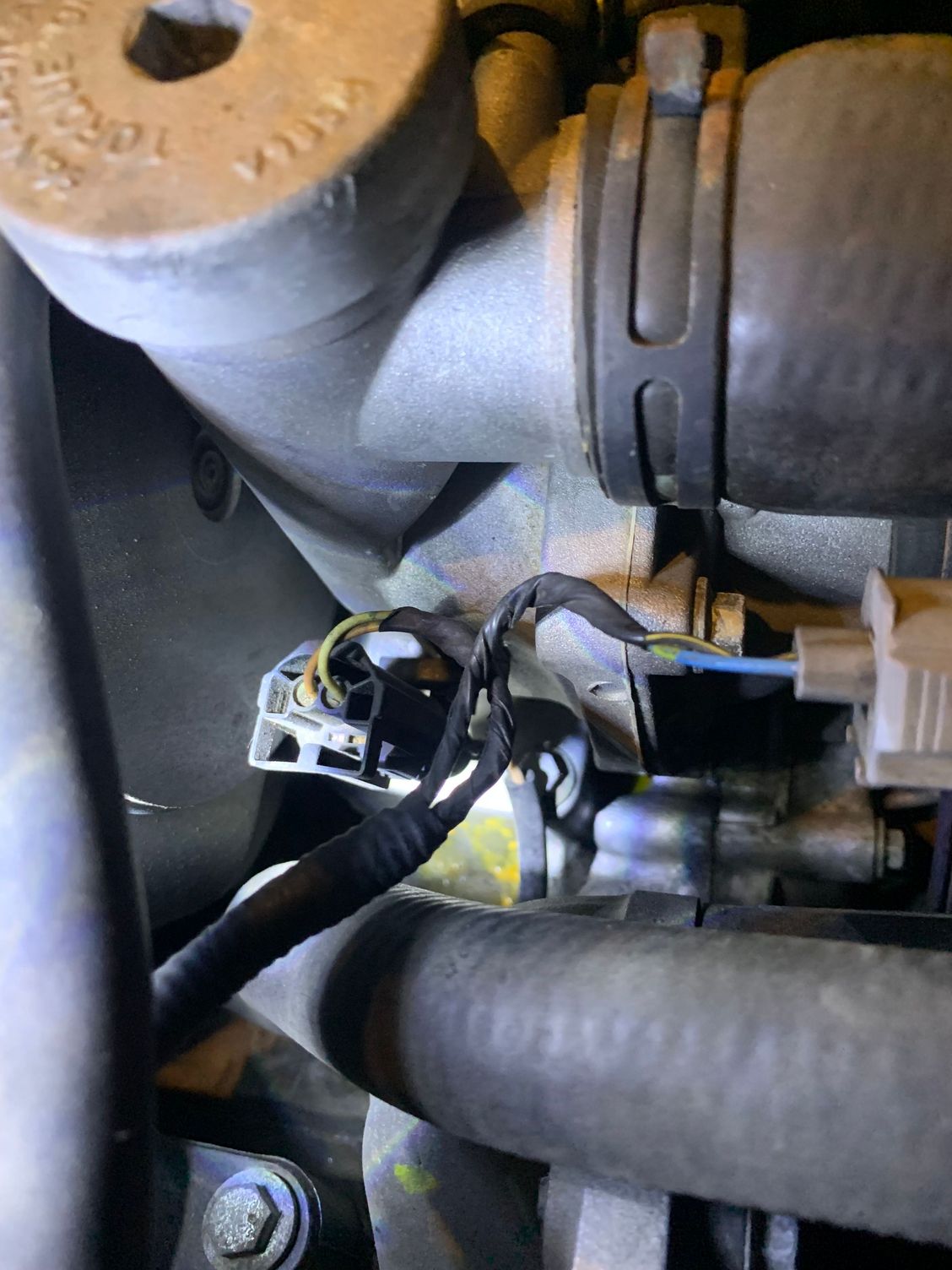

I am in the same situation, see my photos. I'm sure it's coming from that heater hose.
I don't have the money nor time to fix it right now, can't be held off for a few months, or does this need to be done ASAP?
