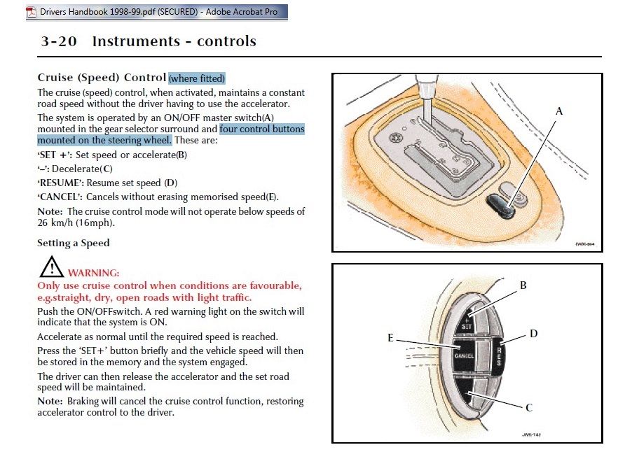

If you don't have the resume/cancel/set switches on the right side of the steering wheel and the cruise button at the bottom of the J gate, then it isn't fitted.

Here is a JPEG file of the 1998-1999 Jaguar XJ Drivers Handbook page on Cruise Control:
Note the "(where fitted)" phrase.
Jim Lombardi

just as I thought! so I will just have to swap it over from my xj8 sport, as in the reading it should not be to complicated.

But it will be complicated. Your ECM has to control it, but you don't have that function programmed, and you don't have the vacuum reservoirs behind the fender liners, or the vacuum switch on the throttle body

Hi RJ237, if you read my comment I have all this on my XJ8 Sport transfer from one car to the other, all the bits that are needed for such a transplant are ont the sport.

Did you also transfer the clockspring, or did the cc wires to the ECM already exist from the original clockspring? I know the cars were often wired for options that were not installed.
