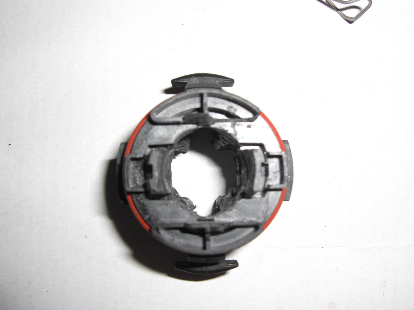

What I didn't know when I ordered the HID's for our Jag, was that our Jag had what appears to be a bulb holder specific to Jaguar. Unfortunately, there is no wire holder on the headlight housing. After checking with HIDeXtra and several other resources, I determined my only option was to modify the Jag plug to accomodate the new HID bulbs and wires.
My first step was to cut the plug loose, remove the connectors then use a dremel tool to cut out the center of the plug to fit the ceramic HID bulb base. Because the nylon/plastic plug was pretty brittle, I proceeded very slowly and conservatively with the grind...at least on the first one. Once I was very close to having the cut just right for the bulb to fit, I switched to a grind stone smooth the cut and make the fit just right.
As you can see, the bulb holder does include a wire, but it is used to hold tension again the bulb to keep it mated to the headlight housing. The clips on both sides of the plug snap into place and hold the bulb and plug assembly to the headlight housing. At first I was concerned with how the new bulb should be aligned, with the wire on top of the bulb, or below. At first I pulled another stock bulb out to confirm the small tab on the existing bulb base was at the top. Then I felt the hole in the headlight housing and realized that the hole also had a notch at the top to correctly align the bulb. Problem solved, tab was to be located at the top.

Once the bulb was secured in the holder/plug, I determined that the opening at the back of the plug was rather large and would almost invite water or moisture to enter thru the rear of the plug. I wanted to seal it, but not to the point that I'd destroy the plug if I had to replace the bulb, so epoxy was out. I chose to cut and use a piece of gray foam pipe insulation. Turns out, it worked perfectly.
