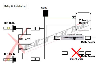

Thumbs up Auto, possible fix
So after searching around the net, I found the auto lights issue isn't unique to Jags, its a common problem with most german cars with canbus tech.
The most assuring way of solving this one light out, flickering etc when in Auto, is to use a dedicated and direct power feed from the battery. This is thru a relay and fuse.
I won't bother soldering the Caps into the light loom, I'm going to fit a harness from the battery direct to the ballasts. Once I've done this, I'm confident the issue will be corrected. Will update once its installed.
Here is what's quoted on HID sellers sites,
HID Troubleshooting
Problem:
In many cases, especially for those cars that have Auto ""ON"" or Daytime Running Lights; one or both light cannot Ignite Initially, Discharge Bulb turns off after just start the car, or even sometimes, bulb just turns off when driving."
Solution:
You MUST Disconnect the Daytime Running Light or Auto Switch ON function immediately before the actual HID Conversion. Due to the Steady levels of battery voltage is required at 12V or Plus before the initial Ignites of each HID Systems; you must prohibit the less voltage draw of car battery at HID s start time. Daytime Running Light is 7V or less power output, and auto switch on headlight is always turn on seconds right before the car to start the ignition to charge the battery, which means Battery is focus on charging the ignition and waiting for alternator to recharge it back to 12V. Therefore, in both situations, battery is drawing much less power than 12V to initially ignite the HID headlight. Please perform the following:
o if you have Daytime Running Light please follow your car s service manual; disconnect the fuse or wiring of Daytime Running lights only.
o If you have Auto Switch On Headlights, please switch the function to Manual Switch On headlights. To avoid further damages, always remember to start your engine before turn on the HID system! "
Here is what the loom looks like....you can find them on-line

While this thread is up on the board, I'll update on the relay loom I bought. While I had a flickering HID I decided to swap the ballasts from one side to the other, the flickering followed. I fitted a replacement, and the loom at the same time. The AUTO lights feature works perfectly now.
I did recharge and fit a fully charged battery.
I fitted the relay loom to the fuse box post, the opposite side from the starter motor post under the bonnet.
I taped and hid the loom amongst factory looms, and it blends in so it almost vanishes.
On cold start with AUTO lights selected, they fired straight away without flicker. I tried it a couple more times letting the bulb cool, and it definitely works as it should now.
If you fit HID's and suffer one side flickering or failing to fire, try another ballast, then fit the relay loom, auto lights should work without issue.
