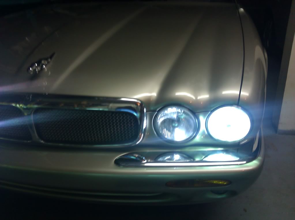

Here is the results of my HID project. Note I also changed the parking light to an LED to better match the color of the new HID lights. The orange-ish light just looked a bit out of place...
The LEDs light up very dimmly for a bit after turn-off, but after a while go out completely, and oddity that doesn't seem to affect anything negatively as far as I can see so far.
The performance of the new lights are an improvement over the OEM stock, and when in high beam (I did the highs also), it is a veritable flame thrower. Yet, on low beam I have yet to have a single flash from an oncoming vehicle. I admit I was apprehensive at first, but no harm, no foul! I am loving the improved night vision, and the stylishness of it all! This is definitely an easy project with a high payback. FYI, I paid $80 for the HID (both high and low beams together), and $20 for the LEDs, so the entire project was just over $100 including shipping.

Looks great Michael. By "...changed the parking light...", are you referring to the carriage light that is housed with the high-beam?
