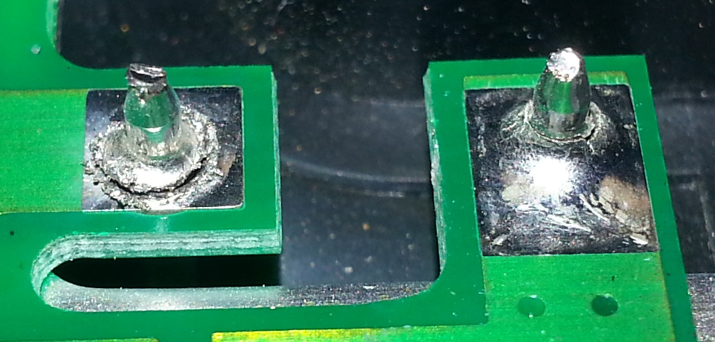

The common fault is the ABS module motor power pins on the circuit board.
I just replace BOTH of my XJ8s ABS modules.
One is the JLM21323 2000MY> and the other is the JLM20555 1999MY.
I have boxes full of modules with DTC C1095 so I just cut the cases open and re-solder the pins.
If I ever find a module with a network fault I SCRAP the module!!!!
I don't know what section of the module to mess with if it fails with anything other than a C1095.
There is info everywhere on the internet about re-soldering the pins so you might try that as a cure or at least preventative maintenance.
I think the 'wave soldering' process in manufacture might not heat the pins enough for a solid, long lasting circuit. They are ALWAYS cracked on the board. Maybe it is not enough solder for the mechanical vibrations of the motor pins?????????
Without a reading of the ABS module you will not be sure of the fault but the re-solder won't hurt.

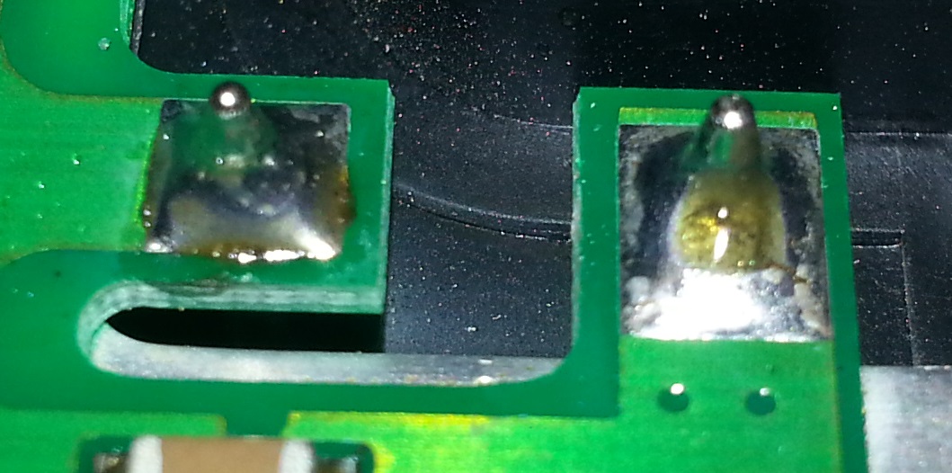

I think I have found the problem with my ABS.
Take a look: Here are the before and after pics.
I put the module back in long enough to test and the ABS light went out right away.
