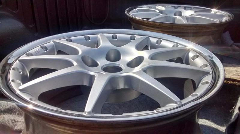

Hi Robert, I see you are located in Toronto. I have a great wheel guy located in Burlington who I can recommend to you.
Here are some examples of work he has done for me:
Let me know if you're interested and I'll PM you his contact information.
