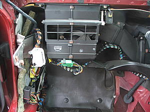

Originally Posted by Addicted2boost
Since we're keeping both of the XJ's, I wonder how hard it is to pull the dash out and replace all that foam? I would go as far as pulling the evaporator and cleaning all the debris out. Man I can't imagine what it looks like after 236K miles with no cabin filter.
Since the X300 and X308 are built on the same basic structure as the XJ40, I would assume that removing the dash is no more difficult in the later models. It's just a matter of removing the knee bolsters (a few screws and fir tree plastic retainers), the instrument cluster (4 screws), the glove box and passenger air bag if so equipped (several screws), and the dash (6 or 8 screws), disconnecting electrical connectors as you go. Here's our '93 dash on the kitchen table for demist vent repair and replacement of the foam and tweeters:
And here's the car with the dash removed:
For the replacement foam I bought sheets of black craft foam from Hobby Lobby and just cut them to shape to fit on the blower motor doors, etc. As I recall, it came in thicknesses of 2 mm and 3 mm and I mostly used the 2 mm. To adhere the foam I used high-temp spray adhesive. For the foam around the heater core and evaporator I think I used some stock foam weatherstrip from Lowes.
I used a shop vac to remove all the foam crumbs that had accumulated between the heater core and evaporator - it was a real mess.
Not difficult at all, just time consuming.
P.S. Accessing your blower motor housings will never be easier than while the dash is out...

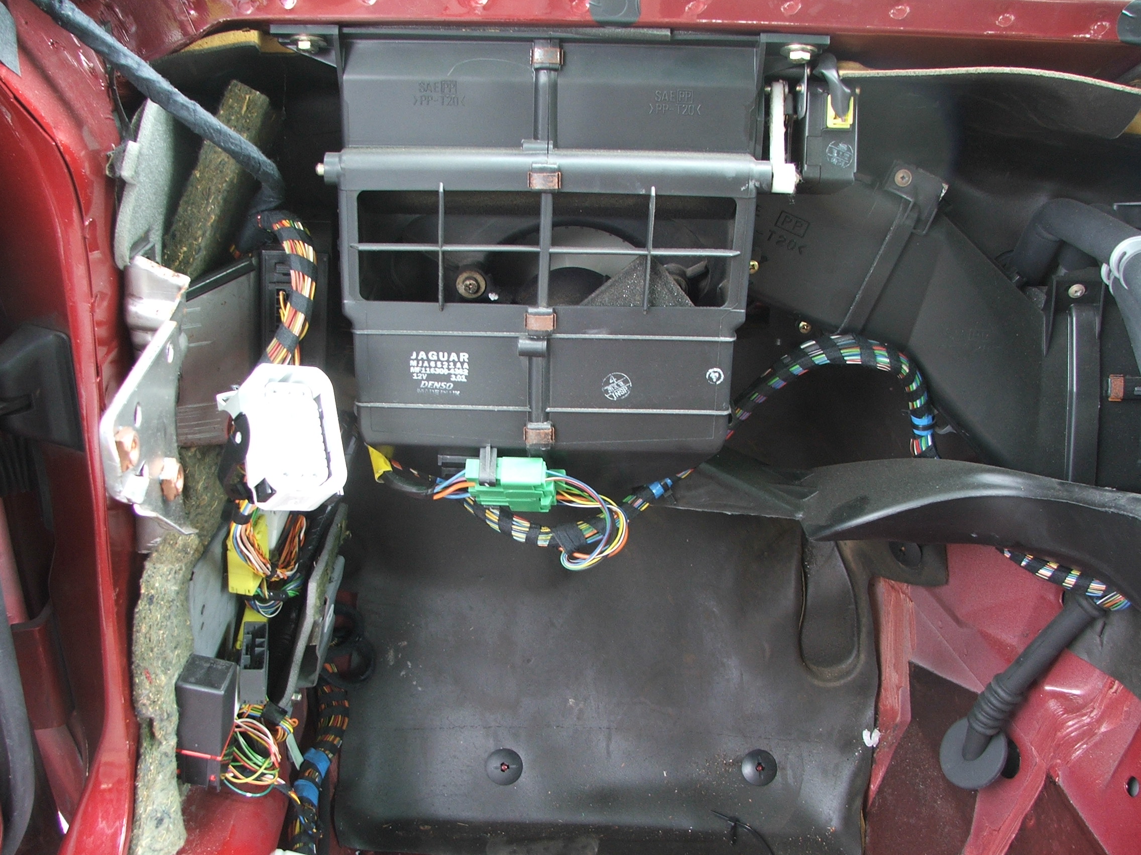

There is a good thread kicking round from a few years ago about this foam issue, the major pieces that can block vents are on the fan motor doors, as seen in my picture, that has literally fallen off the door and is slowly disintegrating - I removed and replaced most of my system while I had the chance.
If you're flexible, you can pull these bits out with a flexi grabber tool and a torch without attempting to dismantle the dash, which is far more substantial than Don B's images.
