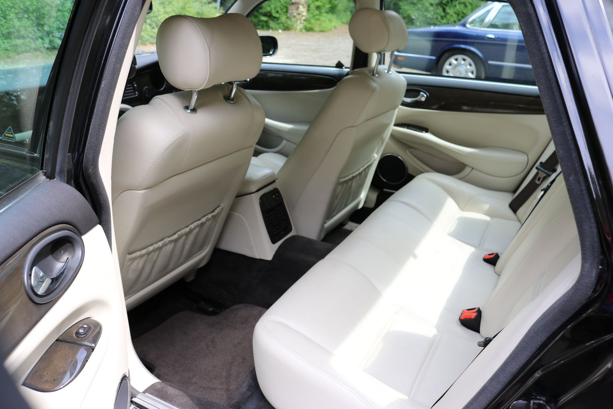

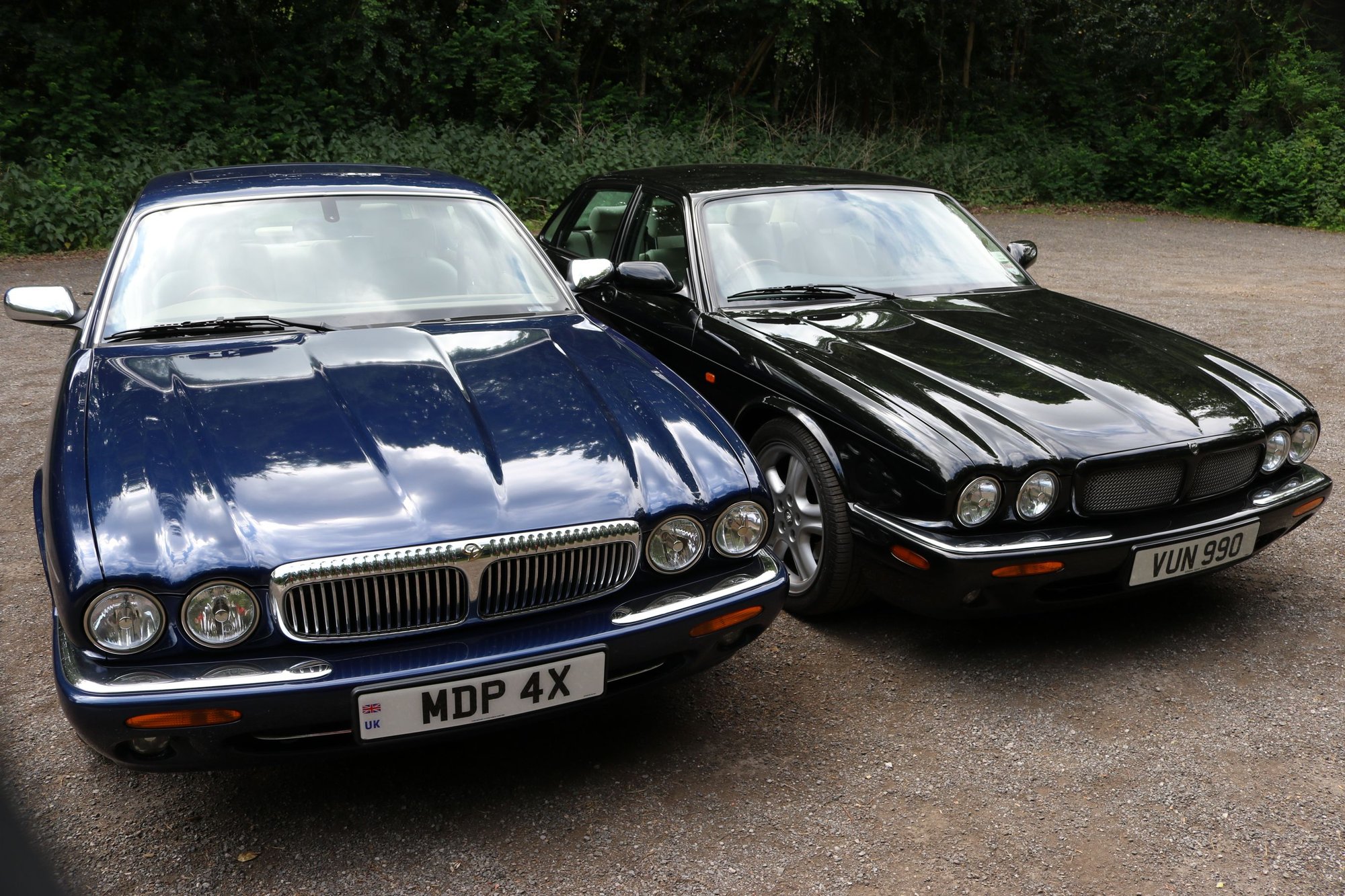

Comfort adaptive suspension and springs on the Daimler Super V8. XJR also has adaptive but my research indicates that the sport springs aret stiffer as are the adaptive shocks. My understanding (borne out when I had to order new shocks for my Daimler) is that it's the presence of a rear anti-roll bar which indicated whether you have sport of comfort suspension on your X308. I'd be interested if anyone knows differently.
By coincidence the X308 model coordinator for the JEC took some pictures of his 1998 XJR and my Super V8 recently. We're going to do a driving comparison then publish an article in the JEC magazine later this year. Here's some of the photos he took - don't you just love that chrome?

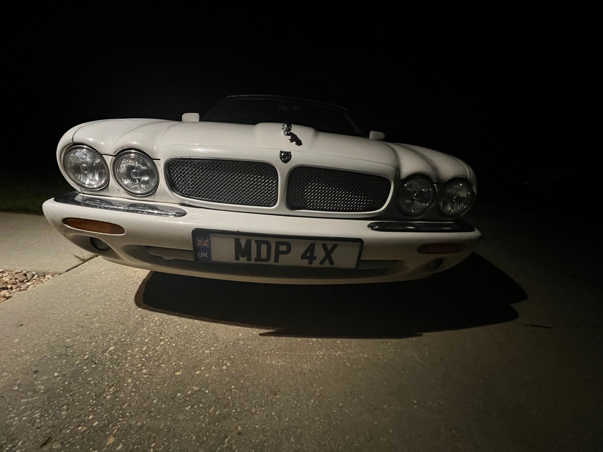

Something looks familiar.

How cool is that? A little bit of the UK over the pond...
Thanks for sharing the photo!

@markdpeter Thanks again for the tag. Figured out the first three are you initials. Haven't figure out the "4X". Really big guy? Fourth Jag/Daimler? Star of movies not to be viewed by anyone under 18?
