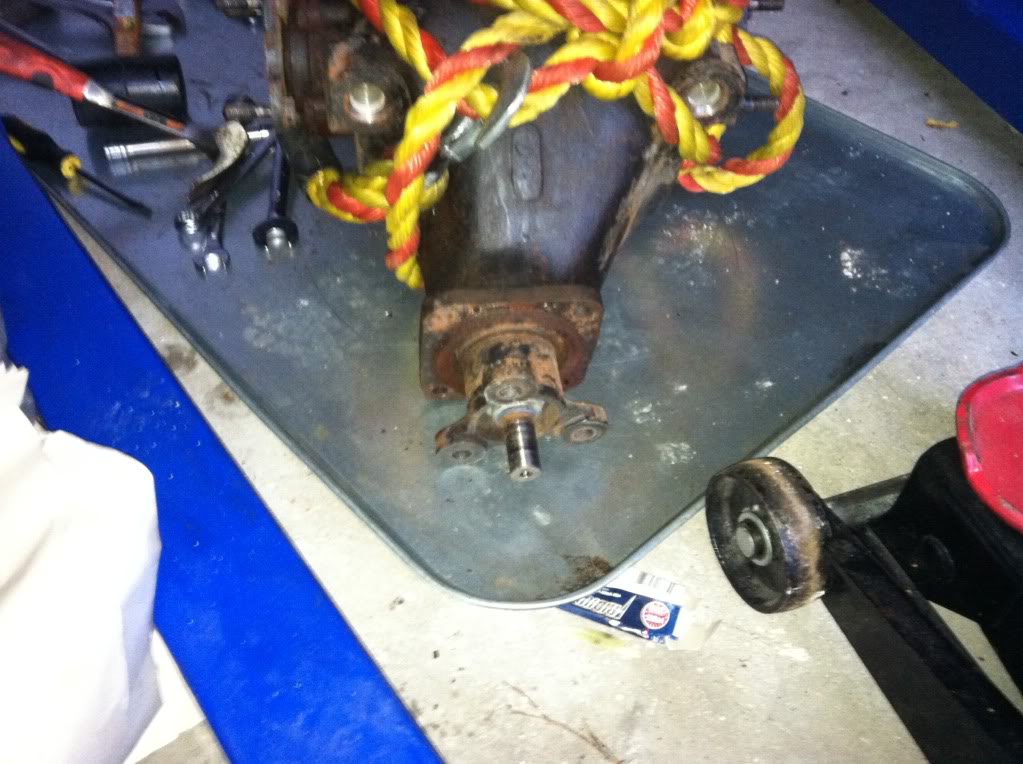

Pictures of my XJ40/X300 'Power-lok' I'm intending to strip:
It's a 15 HU unit. The backing plate indicates it's a 1988 unit and the tag says 3.58 ratio.
I intend to replace both the crown wheel and pinion for a Dana 44 section and possibly the carrier for an LSD unit also.
I have zero interest in reflashing my tcm to make the car into a buzz-bomb on the motorway.
I still have to look into how to tackle the jurid coupling affair as the replacement dana 44 units are intended to place the earlier 4HU units with U joint.
I personally wouldnt touch the weak 14 HU X308 unit now. If I were sticking with that I'd reinforce/shot peen the gears. It seems to be the pinion that fails, I believe it has on my old one too, although I havent stripped it yet.

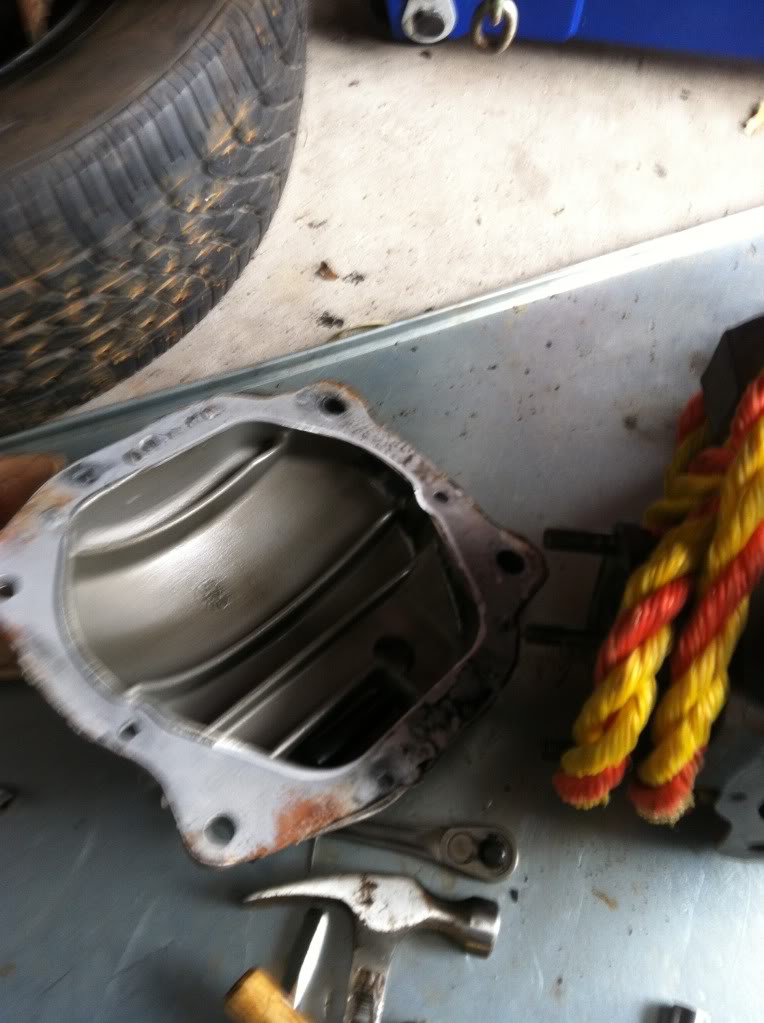

This is a picture of the flange end of the diff.
I cant see the part numbers yet, when I get some better day light...
There is a place in Western Michigan that does fully refurbed units but they usually ask for about a grand as does Coventry West.
These guuys seem to do older diffs also-again not cheap
Jaguar Remanufactured Differentials

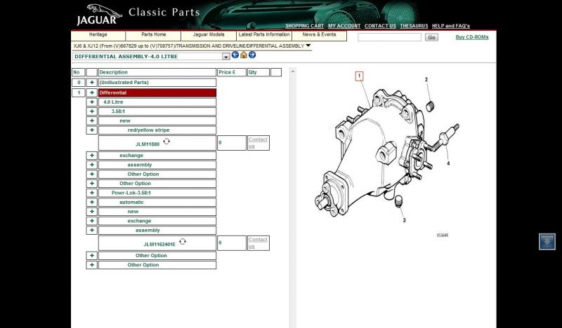

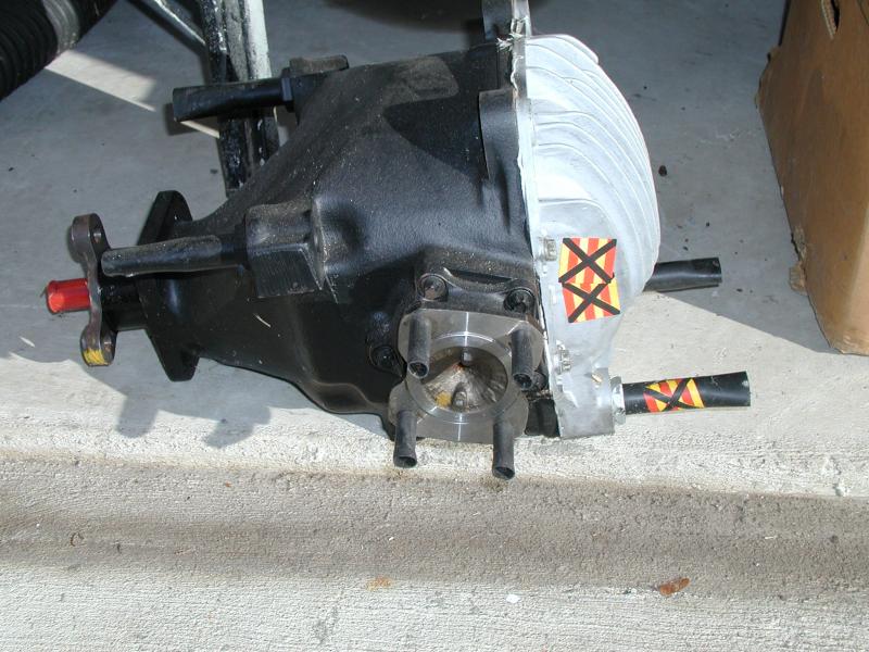

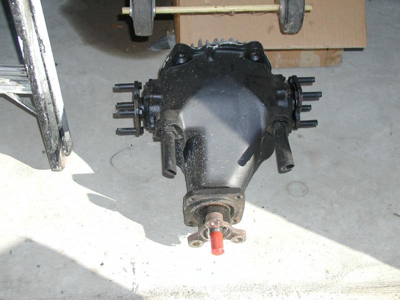

Here are 2 pics of the new diff I have and printout for application thanks to Adam
Attached Thumbnails Differential Rebuild Thread-p2140056.jpg   Differential Rebuild Thread-p2140057.jpg   Differential Rebuild Thread-jlm1162401e-exchange-assembly-looks-like-factory-refurb.jpg

That does look new. Did u get my email?
