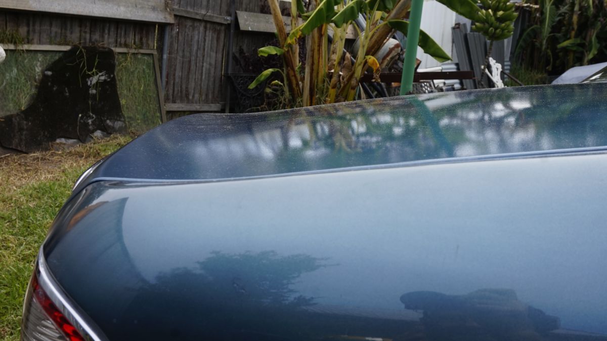

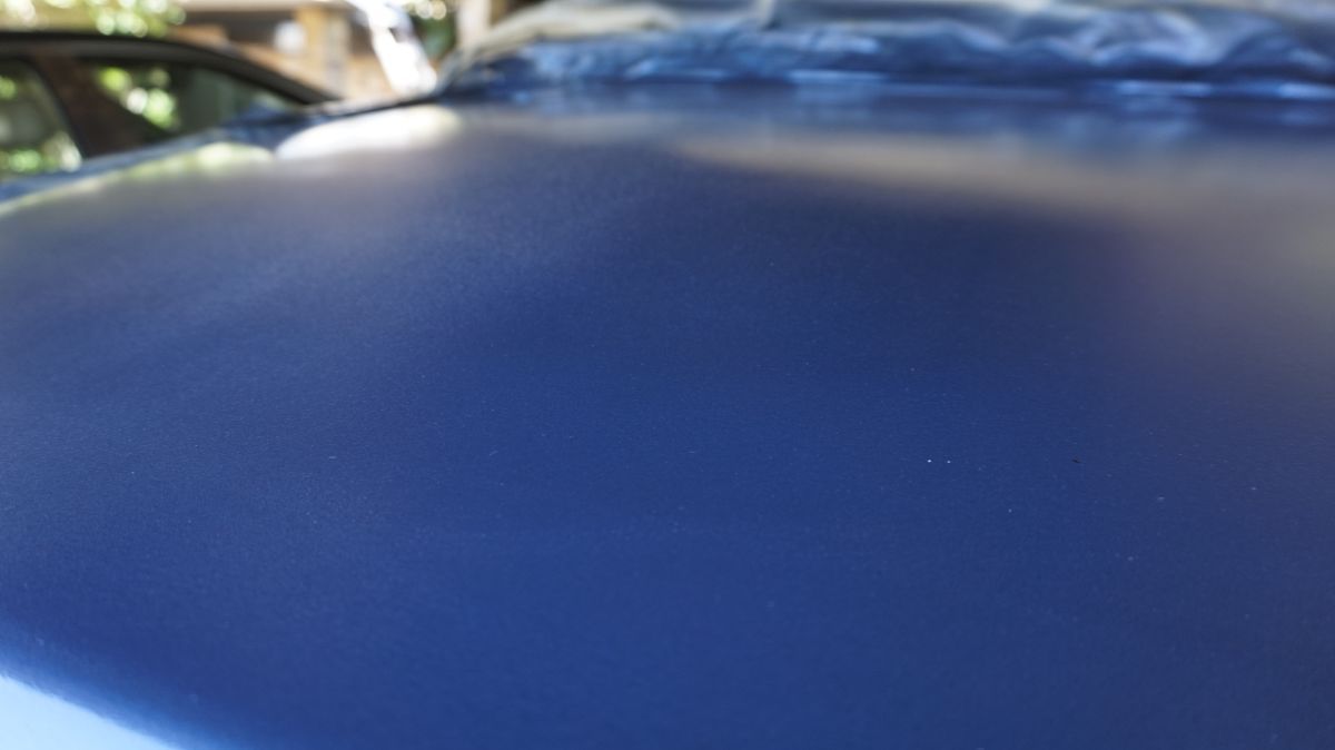

My problem on that trunk lid only (nowhere else) was, that the top of the trunk lid always turned out to be very rough - I could feel the roughness - and obviously that would look horrible - it has to be smooth to look shiny...

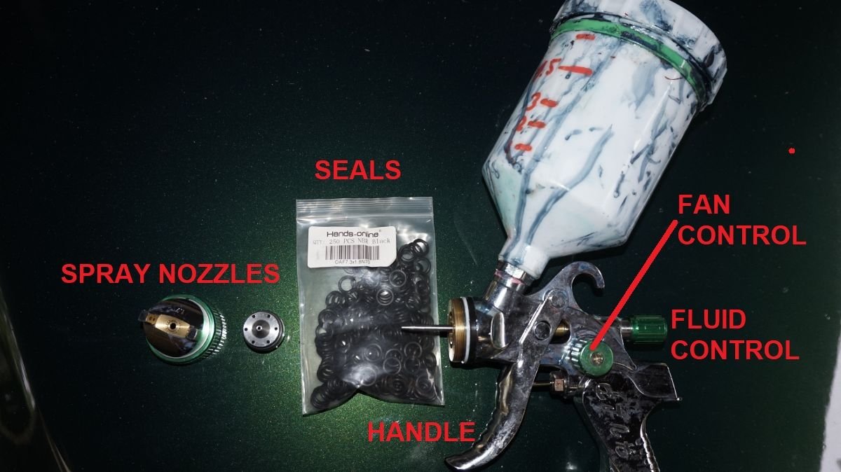

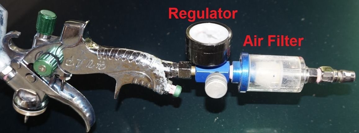

Use a spray gun with the reservoir on top (not below). Press handle and adjust fluid control to wide open (point, where you hit the pressed handle), then another turn clockwise. Fan control: Probably 1 or 2 turns clockwise from wide open (test on cardboard before spraying car). I got myself a bag of 250 seals for the inner spray nozzle - use each time a new seal.
The green regulator knob on the bottom of the gun always remains fully open. Adjust the regulator knob to about 25 psi. And use an air filter, plus before spraying, purge the oily water from your air-compressor.

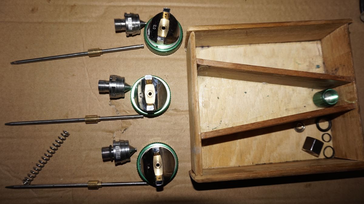

My gun came with all those parts, but without manual - and initially I thought they are just identical spare-parts, but no: They are 3 sets of each 3 parts (do not mix up) for a 1.3, 1.7 and 2mm nozzle.
I made a nice box for them.

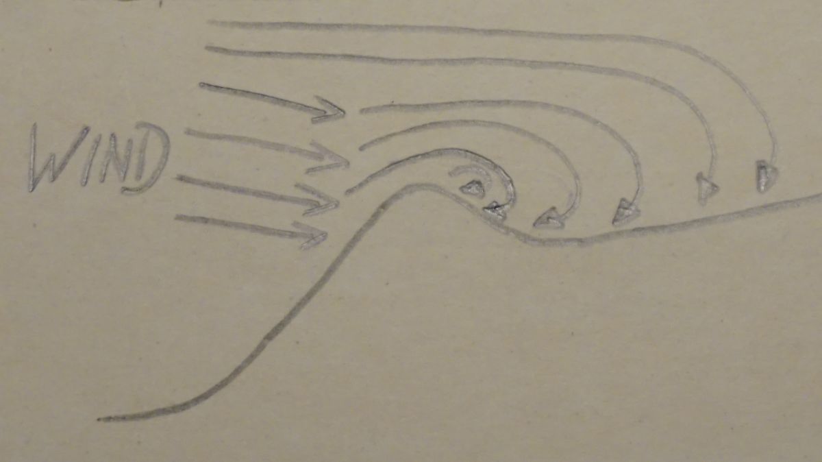

My problem is that what already killed a lot of paragliders, who jumped down from the wind-lee-side of a mountain, thinking the wind comes from the front, when it is really only a turbulence wave caused by the wind hitting the mountain from the other side - from their back. See:
I have drawn this mountain intentionally in the shape of the X308 boot-lid, because this exact same thing happens there: When I spray the surface where the number plate is, some of the sprayed paint with go over the Jaguar-crest of the boot lid, end up in a turbulence and then, long after paint has atomized, set down somewhere on the upper boot-lid surface. This is how "spraying too far away from the substrate" comes into play, and this problem is uniquely created by the special crest-shape of the X308 boot-lid:
So once I recognized WHAT the problem was, I could fix it. Two ways of fixing it:
1. use the wet 1200 grid sandpaper after EVERY layer on the top surface, or (probably better)
2. cover not only all surfaces, which shall not be painted at all, but also the top surface, while you spray the surface, where number plate is...

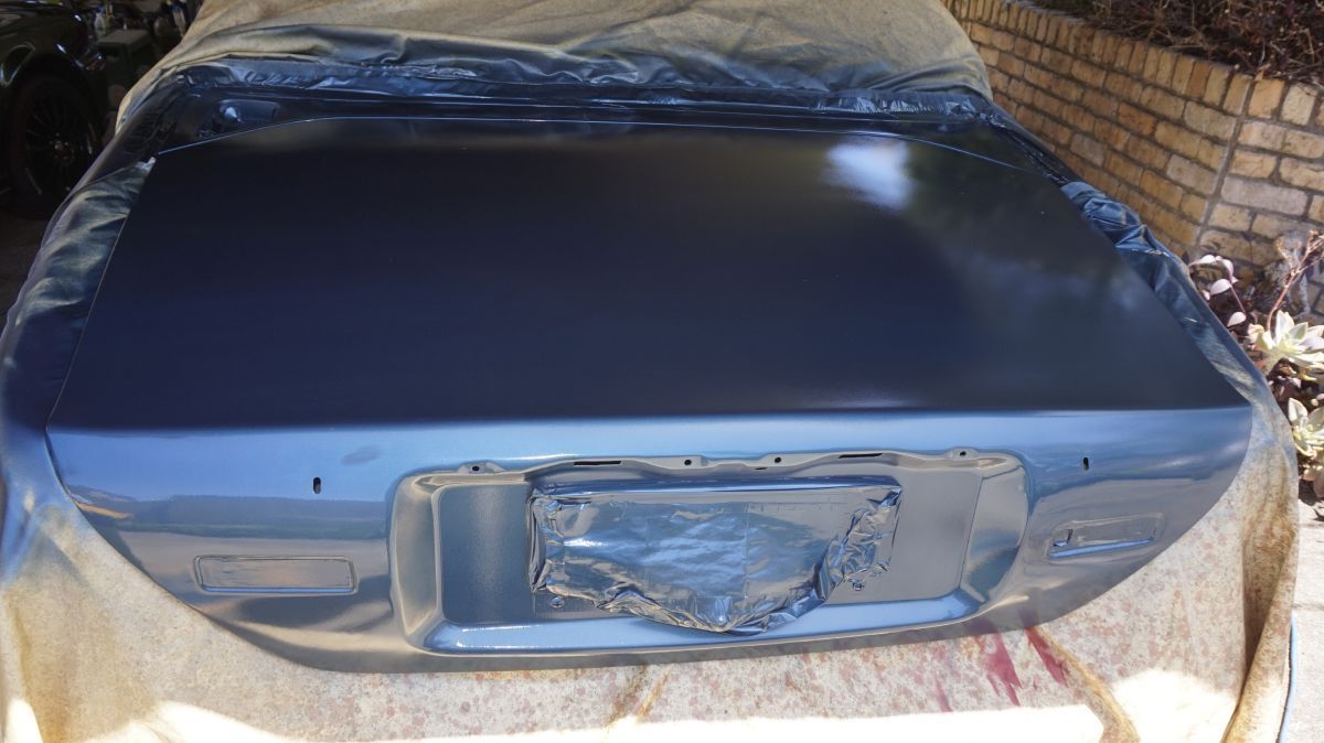

Important: Cover up every surface, which you do not spray paint! I had plenty of old sun-shade, as that stuff does not last for 5 minutes for it's supposed purpose...

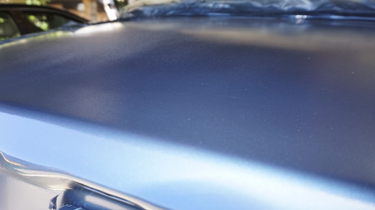

Here you see what have been fighting with: that rough surface caused by paint particles, which atomised before settling down...
...which was, as described above due to the prolonged time they were meandering around for a long time before making contact...
