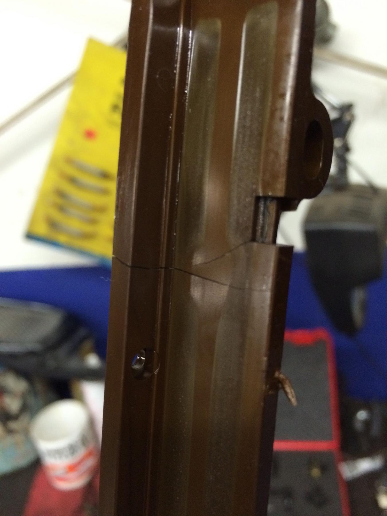

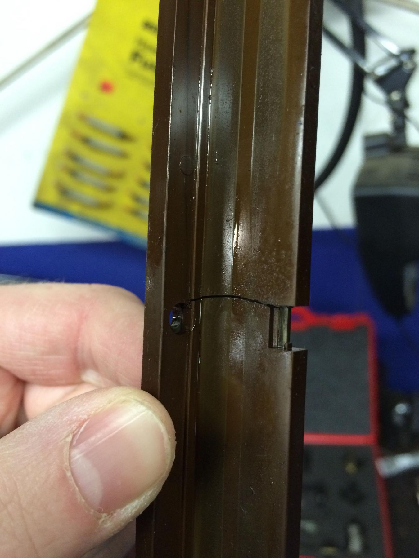

It's been said before, but your XJ is living on borrowed time if you haven't done your tensioners!
Mine supposedly has slightly better materials than earlier cars being an '00 XJR, but look at the cracks!!
Well worth the time and money.

Just had mine done on my xk8 with 68000 on clock, tensioners looked fine, guides were cracked in a dozen places dont know what was holding them together luck i think good luck on your car.

Help me out here .... I'm a little confused by the pics.
Your pics 1 -3 are pretty self explanatory, but what's happening with the other two?
Pic 4 shows collection of parts. I'm seeing what appears to be original style primary tensioners, but later metal-bodied secondary tensioners?
Pic 5 shows what appears to be an original primary tensioner. I realize these need to be replaced regardless, but if the image was supposed to show specific damage or failure, I'm not seeing it.

Hi Retro,
Everything actually looks good except the guides, which are badly cracked. My original primary tensioners look OK, but I've seen them badly cracked as well.
