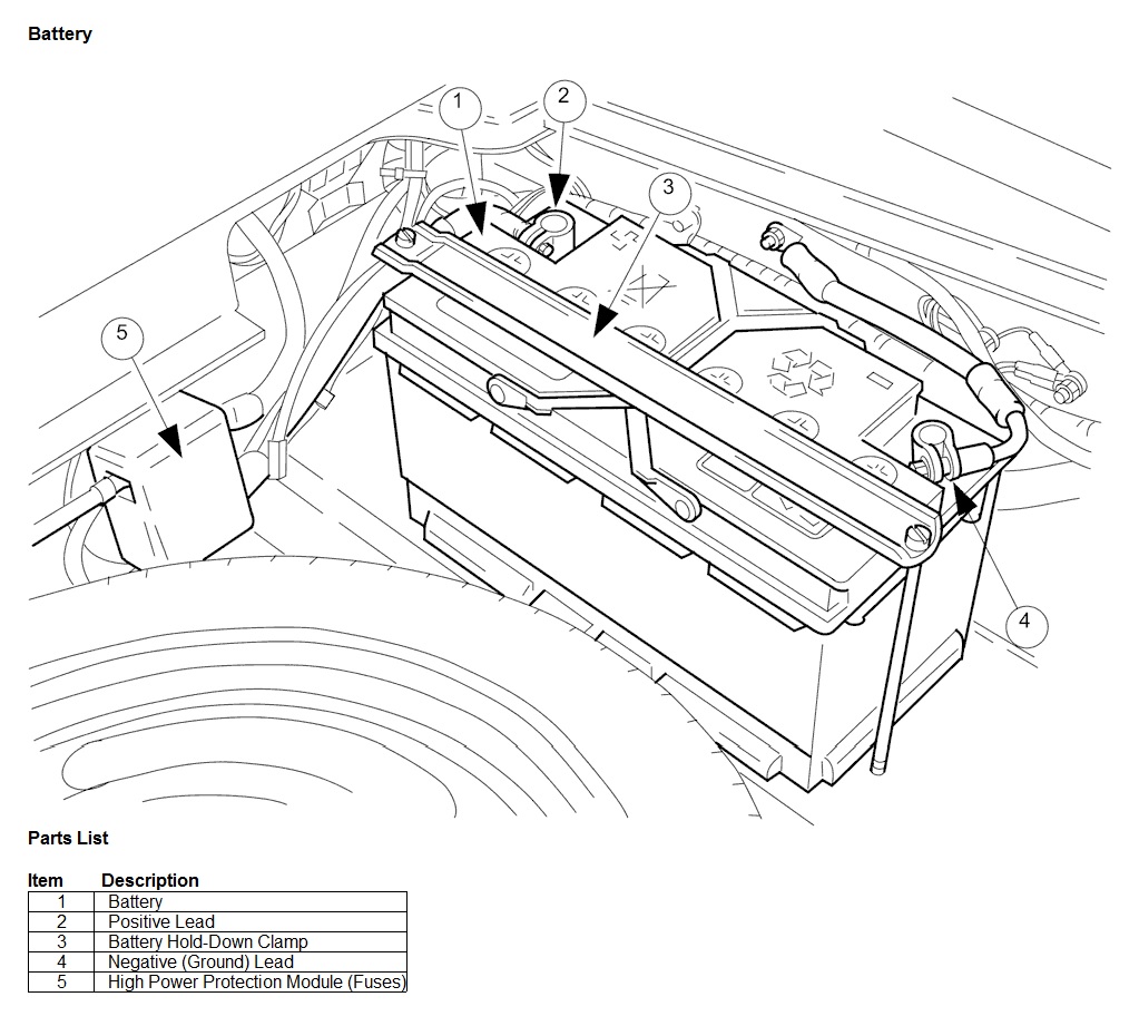

Originally Posted by carl langley
thank you ..new best quality battery £150 ......
I didn't pay that for an OE Varta battery from my Jaguar Dealer!
Add the battery cable connection to the HP Protection Module (item 5) to your check list:
On the X308 and several other Jaguar models, these are known to come loose or even break at the terminal causing odd electrical faults.
