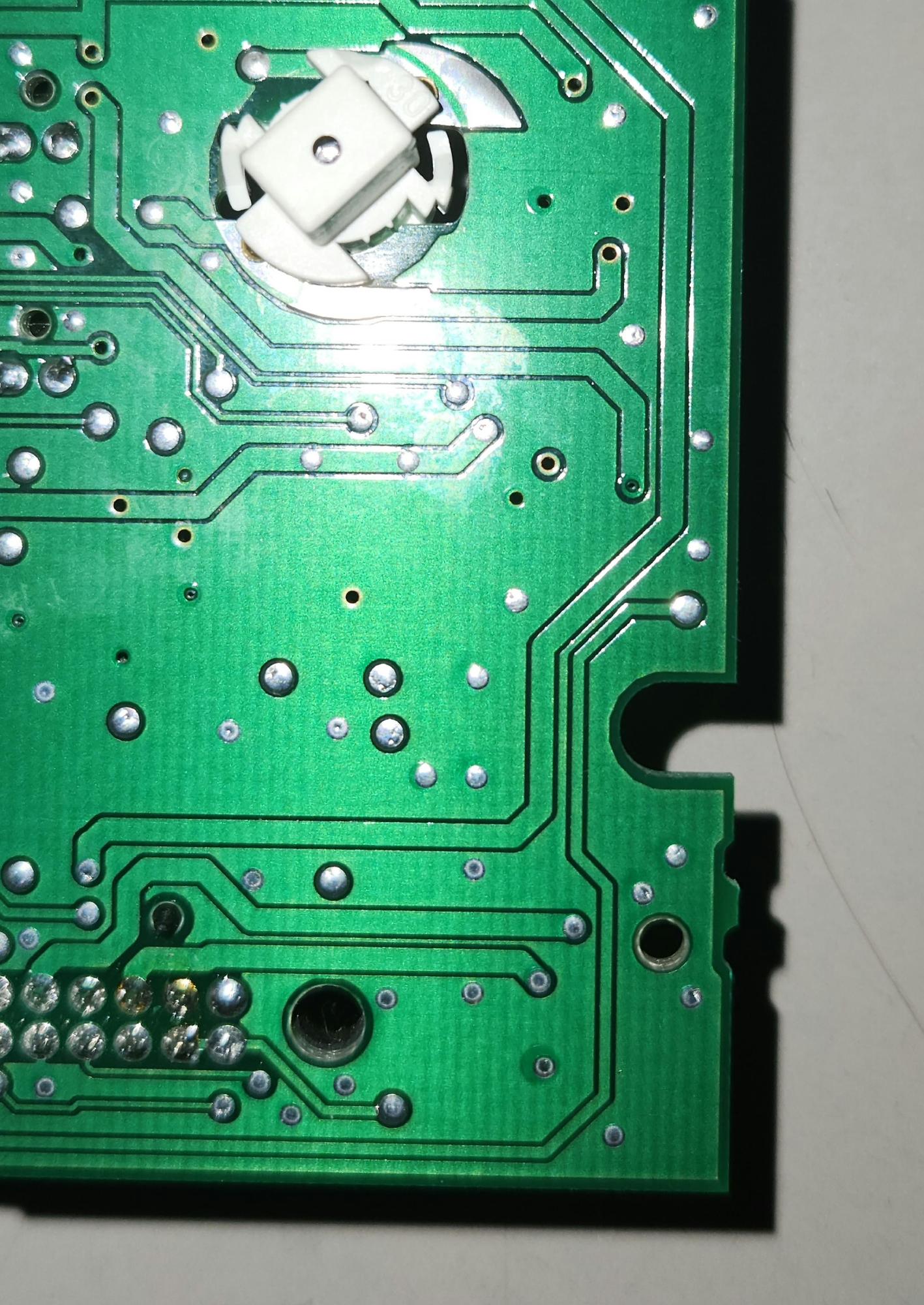

Both joints look suspicious. Ask him do to both.
Old Oct 15, 2025 | 02:03 PM
David N. Warner's Avatar
Joined: Aug 2012
Posts: 424
Likes: 131
From: Lawrenceville GA
This is from the cluster from my 2000 VDP. The board layout looks a bit different. Manufactured on Feb of 2000.
