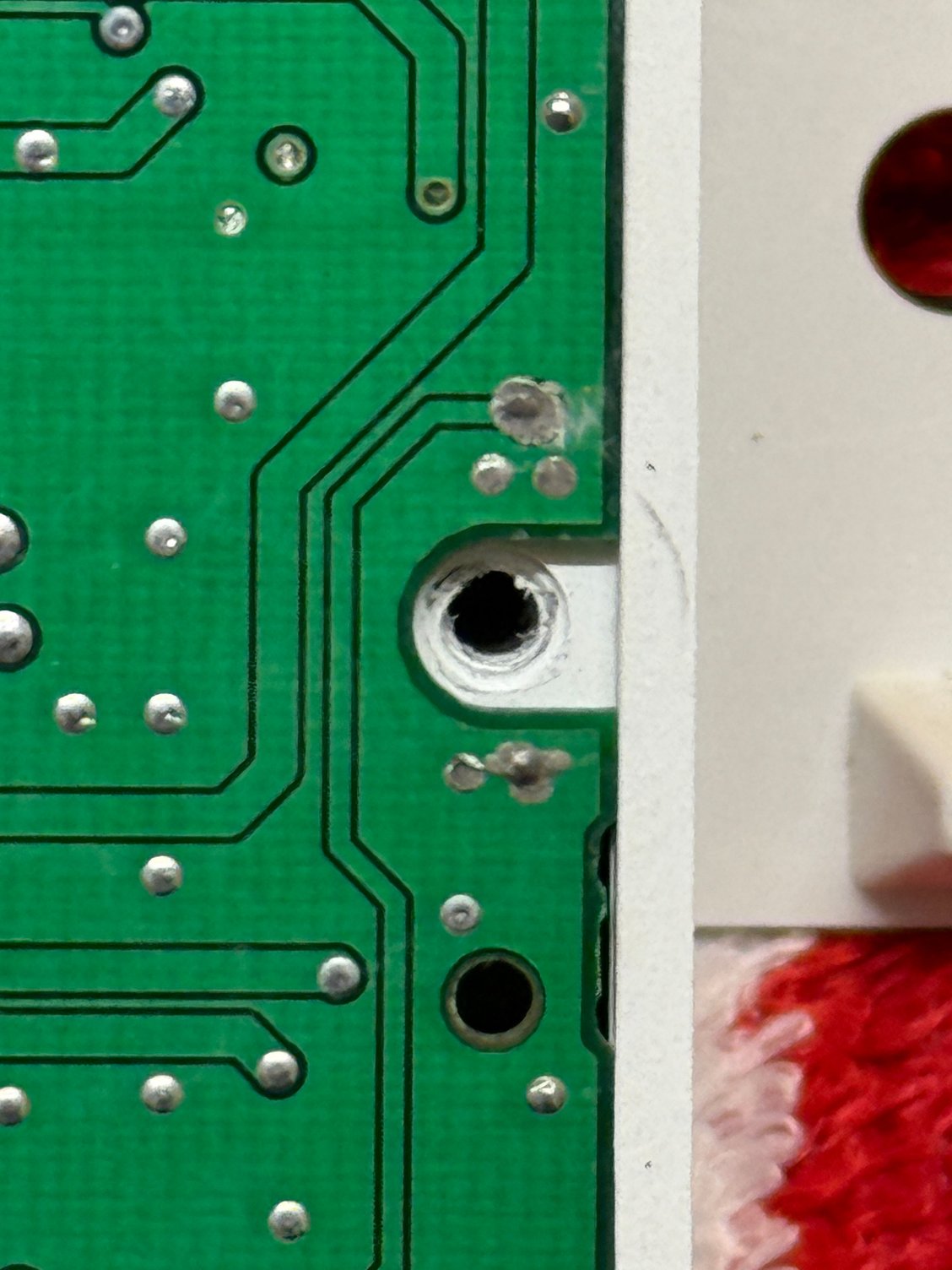

I will take the guage cluster out and check for that solder spot like mentioned in the service bulletin next.

I did check that solder joint on all three of my 2000 VDPs clusters and there was no trace of a solder splash on any of them. Since the replacements, I've never had the cluster problem again.

a buddy of mine was able to take out and disassemble the cluster. Interestingly it doesn't look great, but the spot mentioned in the bulletin looks okay, but another spot looks bad and bridges two spots. This can't be right. My buddy doesn't want to cut that spot, so I need to wait til I am back.
I will try to tell him to check the ground points.
