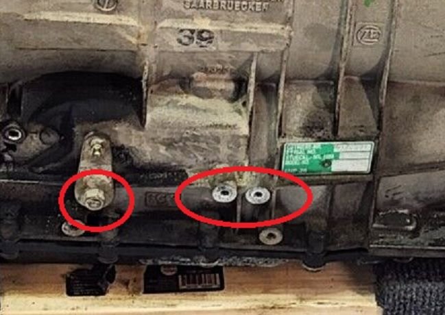

Take a look at this thread as you may have a mechanical shift cable issue. One thing to check are the 2 small 9mm or 10mm bolts holding the shift cable to the transmission. If these are loose or missing things won't line up between the shifter in the console and the transmission itself. The code is saying there is a miss-match.
Cable stretch has also been proposed as the problem.
Here are where the bolts that attach the shift cable. I would get under the car and take a look at the drivers side of the transmission as this picture shows.
