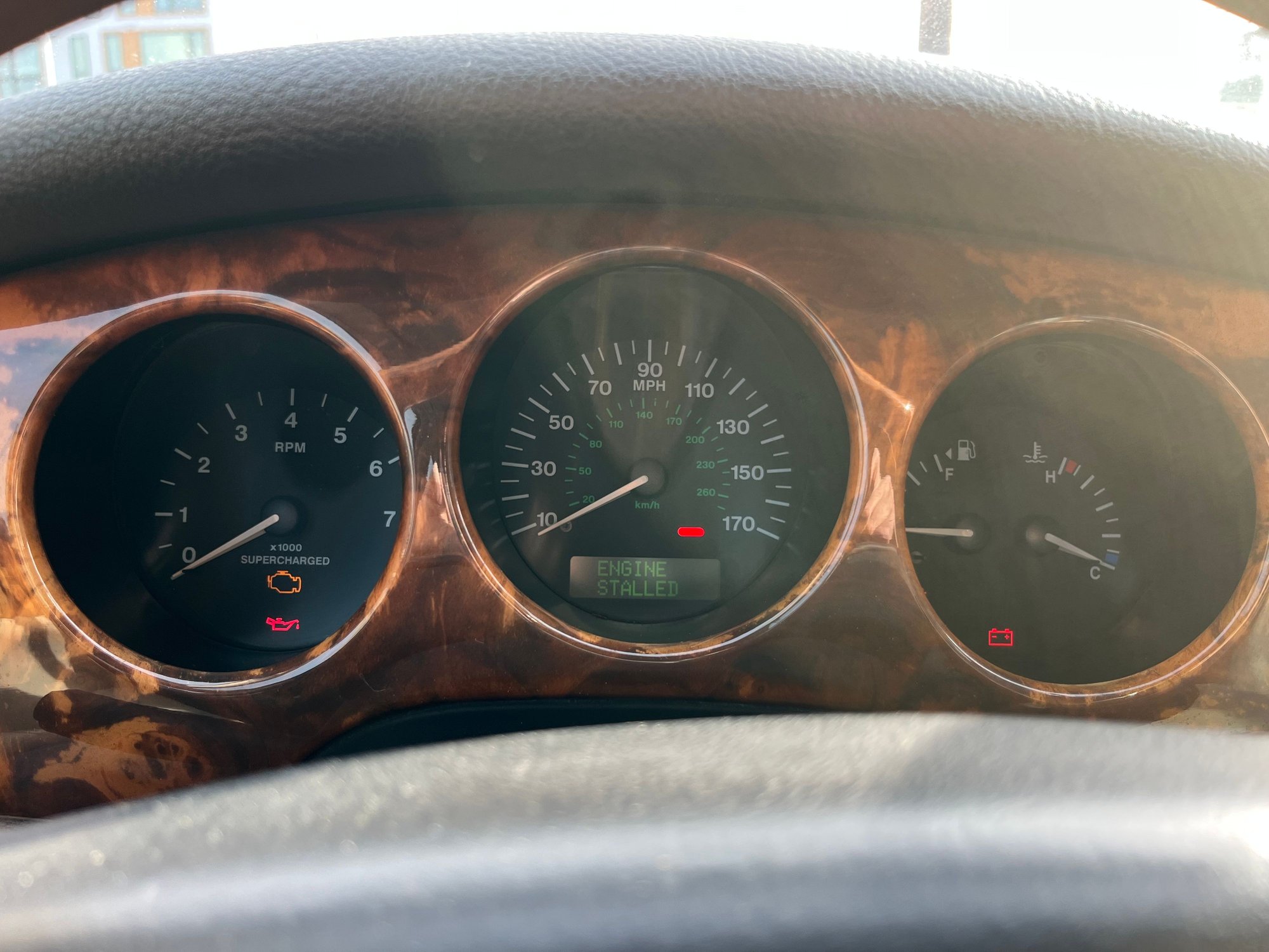

Hello,
my XJR has a new engine as the old one blown after 290000mi.
The engine is stalling after 2 minutes idling.
The mechanic replaced the crank sensor. However, no luck.
Any idea what it could be? Any hint?
Here is a picture, thank you.

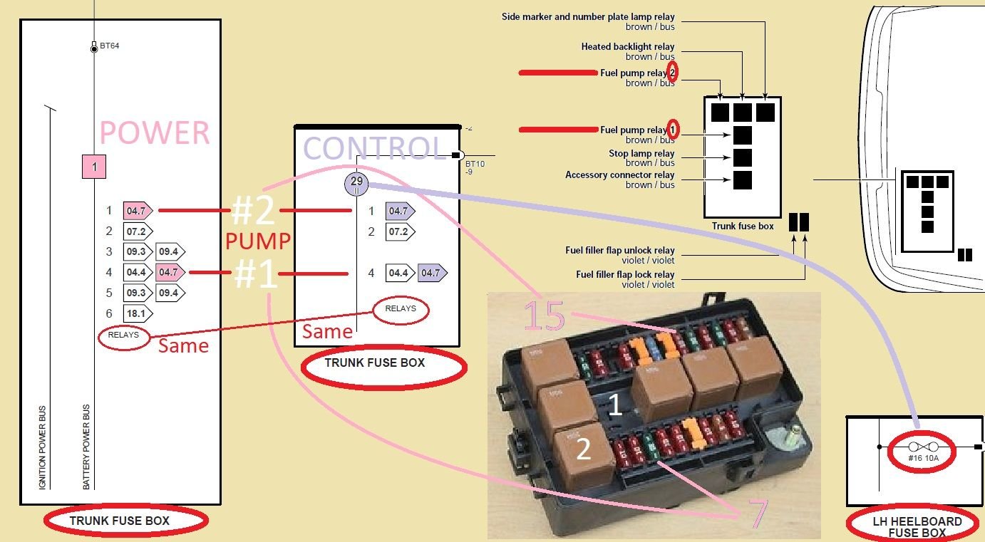

The AJ26 to the AJ27 engine replacement has a different mass air flow sensor wiring at the sensor connector easily missed
There could also be a swapping of the MAF sensor from the original
The CKPS seeing engine rotation is the enable for the fuel pump but there is a secret fuse that closes the relay as fuse X , different than the big mussel power to the pump motor
This fuse X requires the king relay for that fuse box to close which may be intermittent , this relay would be labeled as # 2 ignition positive off top of head , swapping options ?

Fuse # 16 / 10 amp left heelboard fuse box for fuel pump relay control
Relay # 2 ignition positive relay must stay closed , left heelboard

When the engine is cold, you start it and after letting it idle two minutes or so it stalls? No fault codes? Just engine stalls message?

The Jaguar V - 8 does have a specific fuel injector relay up front that can be intermittent and block fuel , you can jumper socket 3 to 5 with blade type connectors for best connection , use the same jumper on the same 3 to 5 on the trunk fuel pump relay or there may be a relay swapping option of the same relay part #
