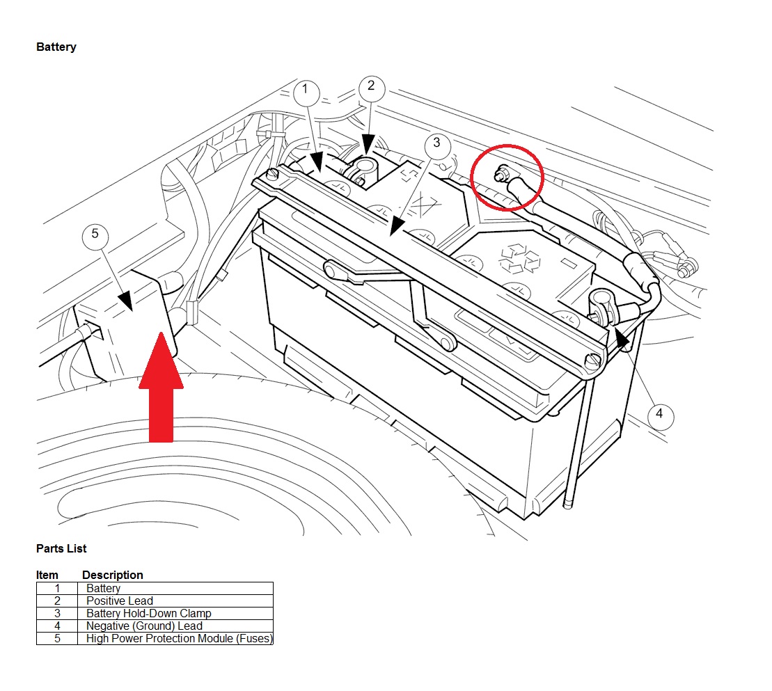

As you have fitted a new battery and it will not jump start, check the cable connections:
1. negative ground (circled in red)
2. positive junction box (arrowed in red)
The positive connection is a known issue for loosening or the cable terminal deteriorating.
