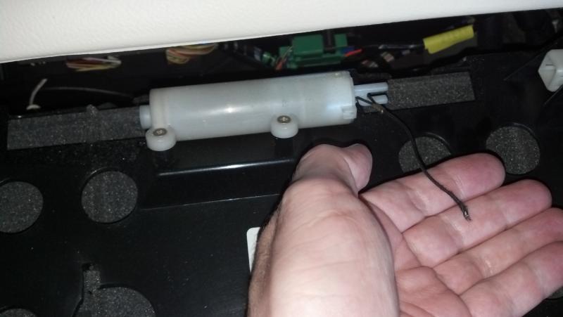

Can easily see white horizontal tube containing the damper/spring & I can see upper 1/2 of broken string attached to right side of damper -- which I can pull out under tension, so it still works. So, both ends of my broken cord maintain their attachments to the damper & ‘drawer’ respectively.
Replacement cord must thread through the white square plastic hole to the right of damper tube. This is where the cord turns 90 degrees to go down towards the drawer. This is also where the stress broke my cord. The cord then goes thru a black plastic ‘tunnel’ & emerges & attaches to rt. side of drawer via a clip. Total length of cord ~ 10”
I considered picture hanging wire as replacement but chose black, thin phone line since stronger. I easily tied one end to damper in same place as broken top 1/2 cord & made several knots. (Yes, all those knots are not pretty) I threaded new wire/cord from damper, thru white square & thru blk tunnel to the bottom rt. side of drawer to the clip (BTW, clip can slide in & out of a groove in the drawer.) The phone line was too thick to attach directly to the clip so I tied it, with many knots, to the loop of broken, very thin original cord which was still attached to the drawer clip.

5 Pix attached.
Attached Thumbnails Fix your glove box damper-jag-glove-box-holding-lower-1-2-damper-cord.jpg   Fix your glove box damper-jag-glove-box-lower-1-2-damper-cord.jpg   Fix your glove box damper-jag-glove-box-holding-upper-1-2-damper-cord-see-white-damper-tube.jpg   Fix your glove box damper-jag-glove-box-pulling-damper-piston-out-see-white-sq-rt-cord.jpg   Fix your glove box damper-jag-glove-box-new-wire-cord-knots.jpg

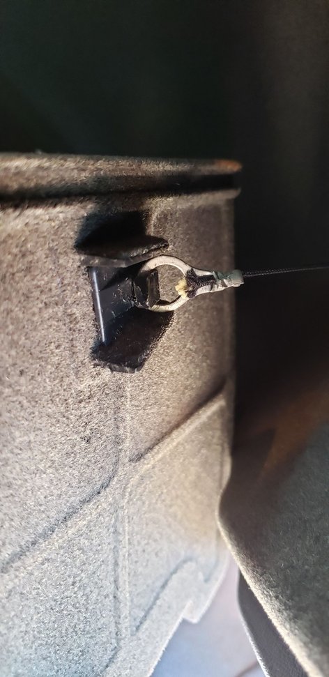

I hope this thread is not too old to reply to. I'm trying to get the glove box out of my 2004 XJ8X350. I followed these instructions on the screws (bolts). Mine still has the clip on the RH side (see photo). It is made to slide into a receiver on the RH side. I would like to open the clip to remove the cord so I can take the glove compartment out. Does anyone know how to release this clip. It doesn't release easily and I don't want to break it. Thanks, Streamsaver.
View looking at RH side of glovebox with only this clip holding it.
